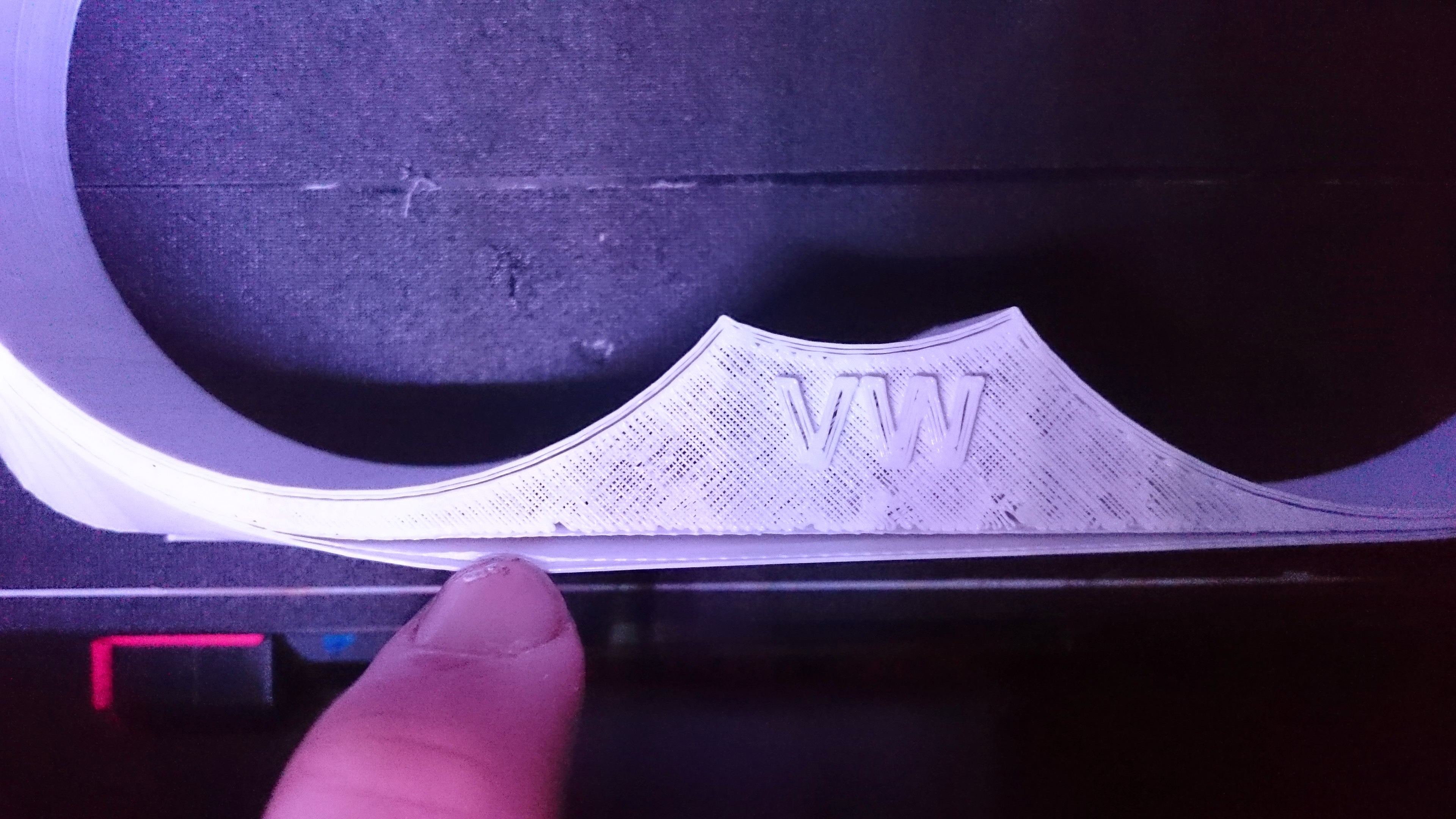

Recently my Rep2 has been doing 2 weird things, and I wondered if you all might have some tips to fix them. First, the shells are not bonding to the infill, as you can see in the picture. Second, the top most layer isnt filling very solidly- you can see through it and poke through it very easily. Thanks in advance!
You’re under extruding. Measure your filament again its probably thinner than you think. So its extruding less plastic than your slicer software is calculating for and thus not enough plastic to join together
Thanks for the tips! I’ll go fuss with my settings and see if it fixes. :slight_smile:
