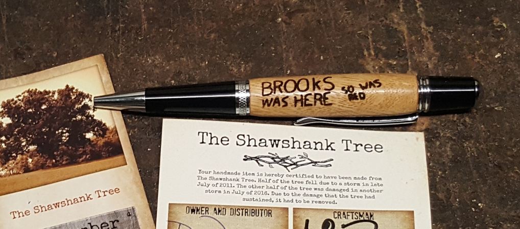

Attached some pics of my most recent tests
