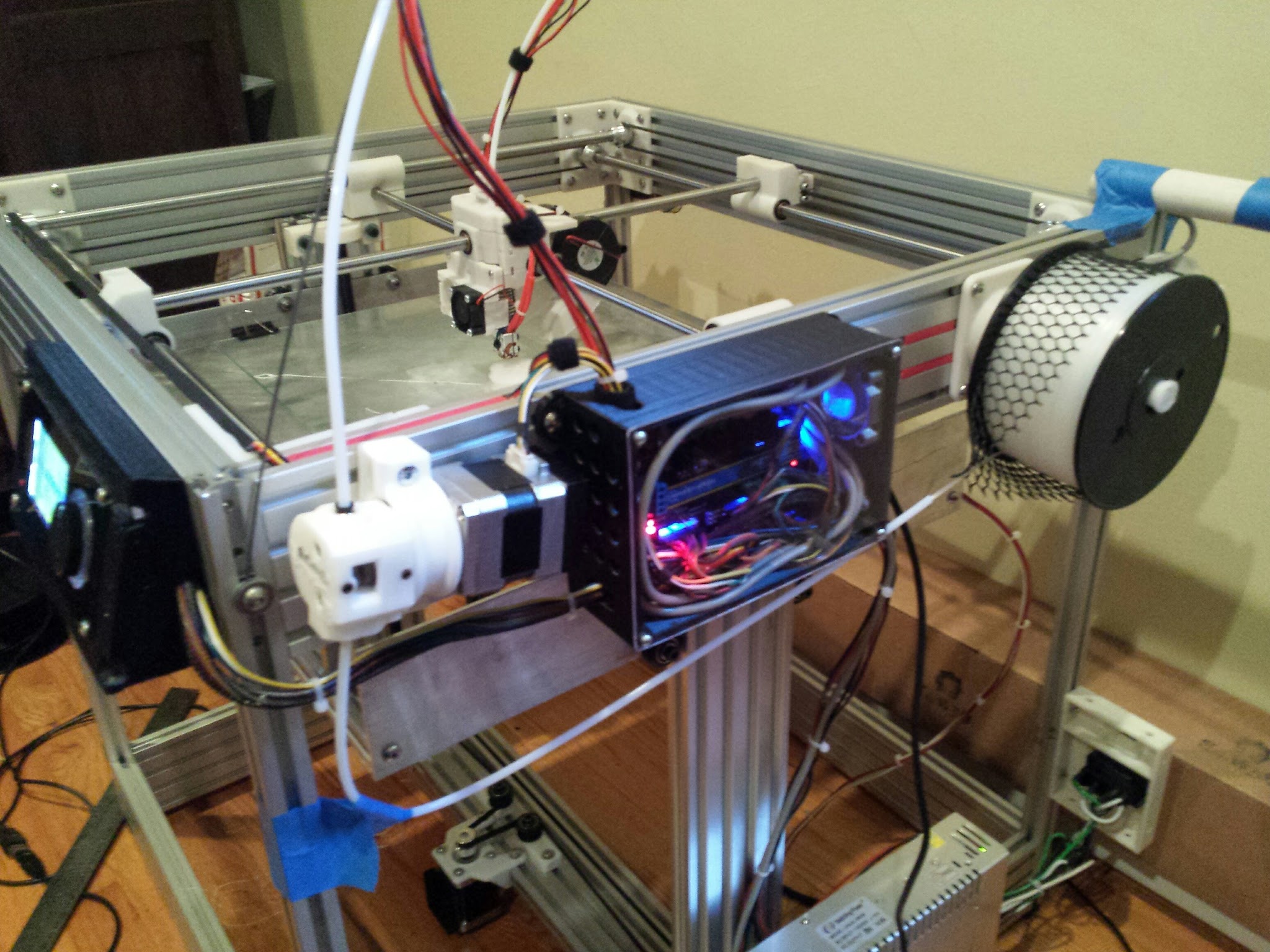

Hi Folks, Finalizing my Herculien build, hopefully today I can get the clear covers mounted. Here is the Azteeg X3 box, front Viki 2 mount on my Herculien. Printing now using a nylon version of the spool holder. Nylon is so nice and strong, I kept breaking them with PLA and ABS prints. I could not find the 12 mm and 25 mm holder so I modified the 50mm version and uploaded them to http://youmagine.com. As you can see my Bondtech is pulling hard on that spool netting and no signs of giving up. I think I may have to make another printer part so it can replace that blue tape. Also I am redoing the power receptacle since the power supply will be mounted outside the box since I have opted not to cut any of the acrylic covers.
I am thinking about replacing the carriage with a single Eustathios V2 carriage, do you guys think a nylon bridge filament can handle the heat or should I stick with ABS?
Nylon should work fine. Love the build an enclosure. Great job all around.
My Carriage is completely printed from HDGlass (PETG) - including the Fan duct. Works well until now, so Nylon should work even better.
Thanks guys will make with nylon.
Well the top portion printed nice with nylon but that bottom air blower is too hard to print with nylon. It basically catches itself on the inner wall of the blower because of softness of nylon when printing. I am going to reprint with ABS and also will print the V4 hot end clamp version
@Eclsnowman I think we need to make the holes on the bushing bearing a bit larger. The average folks will have a hard time pushing the bearings through. I have plenty of tools in my shop but for those who do not will have a tough time.
@Vic_Catalasan Do you mean on the carriage? If so I have them under sized .1mm so I can soften the ABS hole with acetone on a q-tip and press in the bushing for a firm fit. The ABS then re-solidifies making a perfect fit and the bushing then is essentially glued in.
