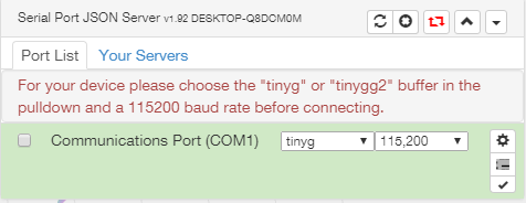

It says you’re disconnected in the one screenshot, so that would be why you wouldn’t see COM ports at all. It would be easier if you were giving us full screenshots too because I want to know if you are using an HTTPS:// url or not because that’s a top candidate for errors.
Take a look at your javascript console and you’ll probably see the error. You can’t connect to spjs via websocket without ssl if you’re on an ssl website.
