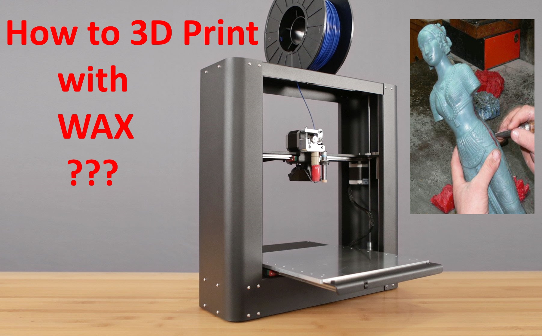

Hi folks maybe you can give me some advice, I try to find infos online, but was not successful.
I ordered for our school from MachinableWax some nice wax filament, for casting bigger in bronze and silver (using 3D printed wax designs) …
The company advise to print at 135-140c. Celsius. After getting our “Printrbot Metal Plus” ready, I found out that Cura is telling me “cold extrusion prevented” !
QUESTION:
  • Is there a easy option to “disable” cold extrusion prevention ?
  • What else can I do to get the Printrbot printing in low temperature ?
  • If not what other (cheaper) printer could I buy, to print low temperature ?
I also wroth the team from Printrbot, asking them the same question, the answer which came back was as followed =
I apologize for the late reply, unfortunately there is not an easy way to stop the cold extrusion for low temp filament. The lowest temp that will not cause a “cold extrusion” would be 170C
Thanks for help
Best
Frank
