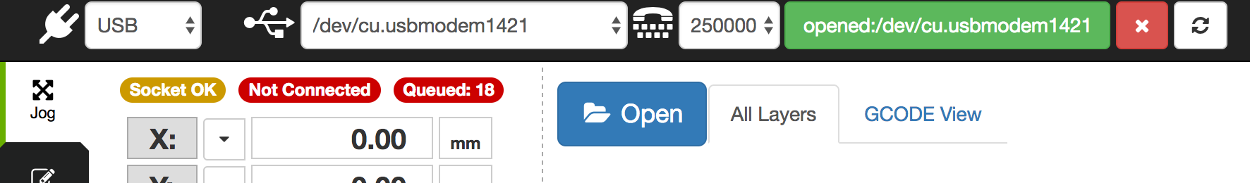

Well, I thought so anyway. Now it says “Opened”, but sending jog commands isn’t doing anything.
How is it that I see both “Opened” and “Not Connected” at the same time in the UI?

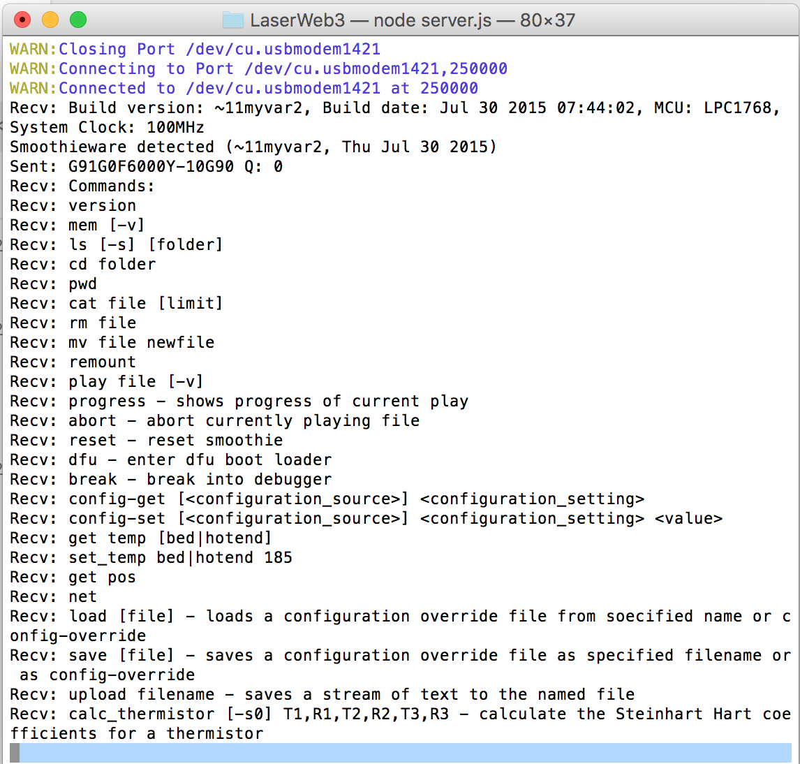

@Ariel_Yahni_UniKpty picture attached. When I click any of the job controls, nothing happens in terminal. Not sure if it should or not.
Notice how it says Queued: 18. When I click any jog controls, that goes up by 1.
Did you install the newest http://firmware-cnc.bin on your smoorhieboard? (save the file as http://firmware.bin on the sd card and reboot smoothie)
That’s means it’s not communicating, do you have a fairly new firmware on that smoothie? Press control C interminable to close LW, close the webpage. Press the restart button the board, start LW again, open the browser to LW and then press connect
