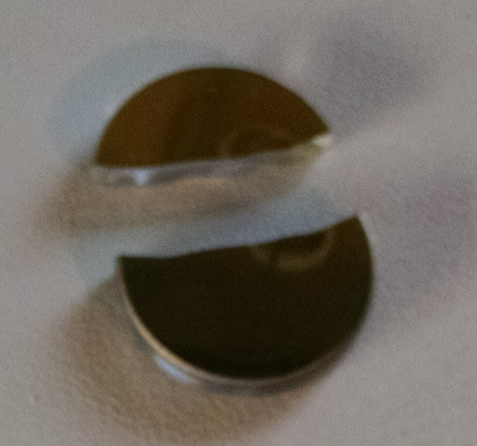

I went to do the alignment and put tape over mirror 1 without looking to closely. Test fired it, seemed ok. Took off the tape and noticed a line through the mirror. Guess I found the problem. Any ideas why this happened? Cuz it seems like it was working fine and then it wasn’t. I still have the mirror I took out of the stock head, going to install that as mirror 1 now.
I cracked mine by tightening it too much. I have seen mirrors crack from heat build up as well. They get dirty and then heat up.
Debris heated up on the suface of the mirror. If it cant reflect the beam it has to absorb it. If this happens to your lense use rubber gloves and dont inhale the dust. It is highly toxic. I would go ahead and clean the mirrors and lense before firing again.
