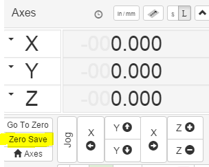

Hi friends, i replace the “Zero Out” Button with Zero Save. This button will save your zero position. GRBL calculates the offsets from machine origin and stores them in non-volatile memory (EEPROM). After hard reset or power off, home your machine and done. This are only a nice to have, i want to add ctrl+click feature to this button, but this widget catch all key events
You may want to check out how the TinyG workspace does it. I think it has the best balance and supports the Work Coordinate Systems widget which shows which layer is active G54/G55/G56 etc.
