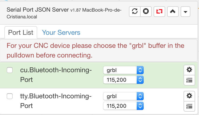

@Get_Hands_Dirty this would mean that your Arduino Nano is not being seen by your Mac as a serial port. Are you able to see it on your mac in any other list as a serial port? Are you sure it’s plugged into your mac correctly with a data USB cable, i.e. not just a charging cable?
@jlauer Hello John, thank you for getting back to me. The cable should be fine because I already connected the laser machine with a windows pc and had things burned on Benbox.
The only ports I can see are those two. missing/deleted image from Google+
Your OS isn’t showing the port from the photo you just posted, so that’s an OS thing, not a ChiliPeppr thing. Do you perhaps not have a driver for that FTDI chip?
