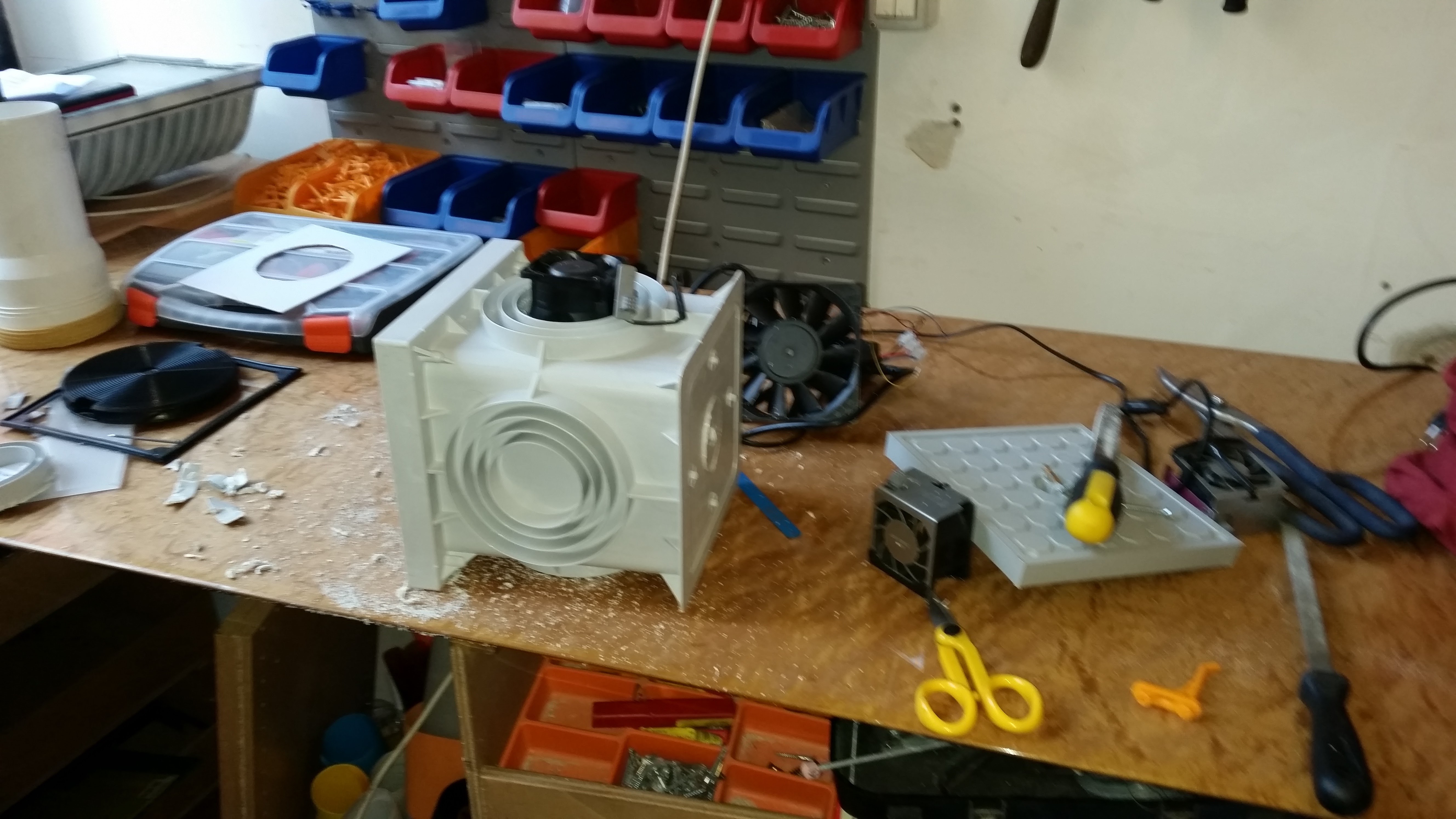

Hi, guys finaly go in lab and make this.
An basic air filter for we lasers,with carbon filters.
praticaly same in cooking we have hook why no clean little we output air before push out?
surely is not same 5k euro filter (we have one ) but it necessary if want use in a flat .
what i use:
2 high power fan 12cm 12v 3.25A and 5cm 1.25A
20cmx20cm hermetic drawpit
1 carbon filter for hook 15cm dimeter
1 piece of plastic
1 filter for hook
1 hepa filter(need to buy)
surely some noise…sure air more pure of normaly.
fan direction:
5cm->drawpit->12cm->
filters :
from laser >filter for hook>hepa->carbon filter–>room or out.
Soon other mod
