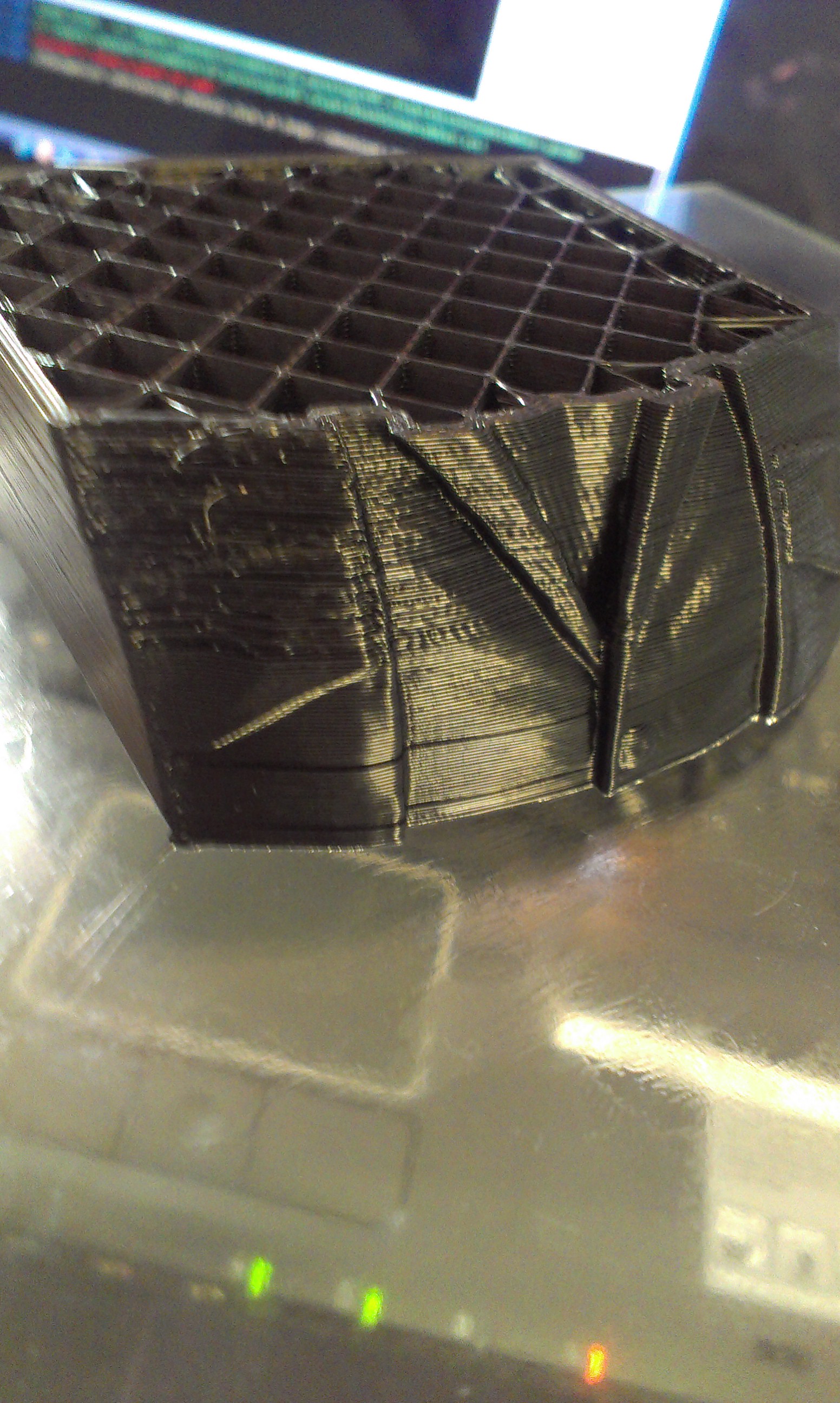

Help needed. Has anyone got any ideas of what’s going on here?
It’s meant to be a Dynamite bust but at about 10mm off the build plate the front left hand corner started to appear rough.
I’m printing with PLA at 185c with a layer hight of 0.2mm and with an extra 2 shells.
I’m slicing with Replicator G on a Flashforge. I set the infill at 10% and the build plate to 40c with hairspray.
When watching it print it seemed to lay the first internal shell fine and then would miss print the second and external shells. Apart from this the print was perfect.
Any help would be must appreciated.

Whaaaaaaaa? Yikes. Last release of that software was 2 years ago. How about trying a modern slicer?
Also, that looks like the area where you’re changing Z height. Make sure your retraction settings are correct. It might simply not be priming enough before starting that outer edge and taking a little bit of distance before it’s spitting out enough plastic.
Looks like inconstant pressure on your filament.
Thanks for the help.
Looking at the retraction issue. I think that it might be due to the Sailfish firmware not adjusting the retraction when you increase the speed from the printer itself.
I’ll try again and set the speed when generating the gcode.
