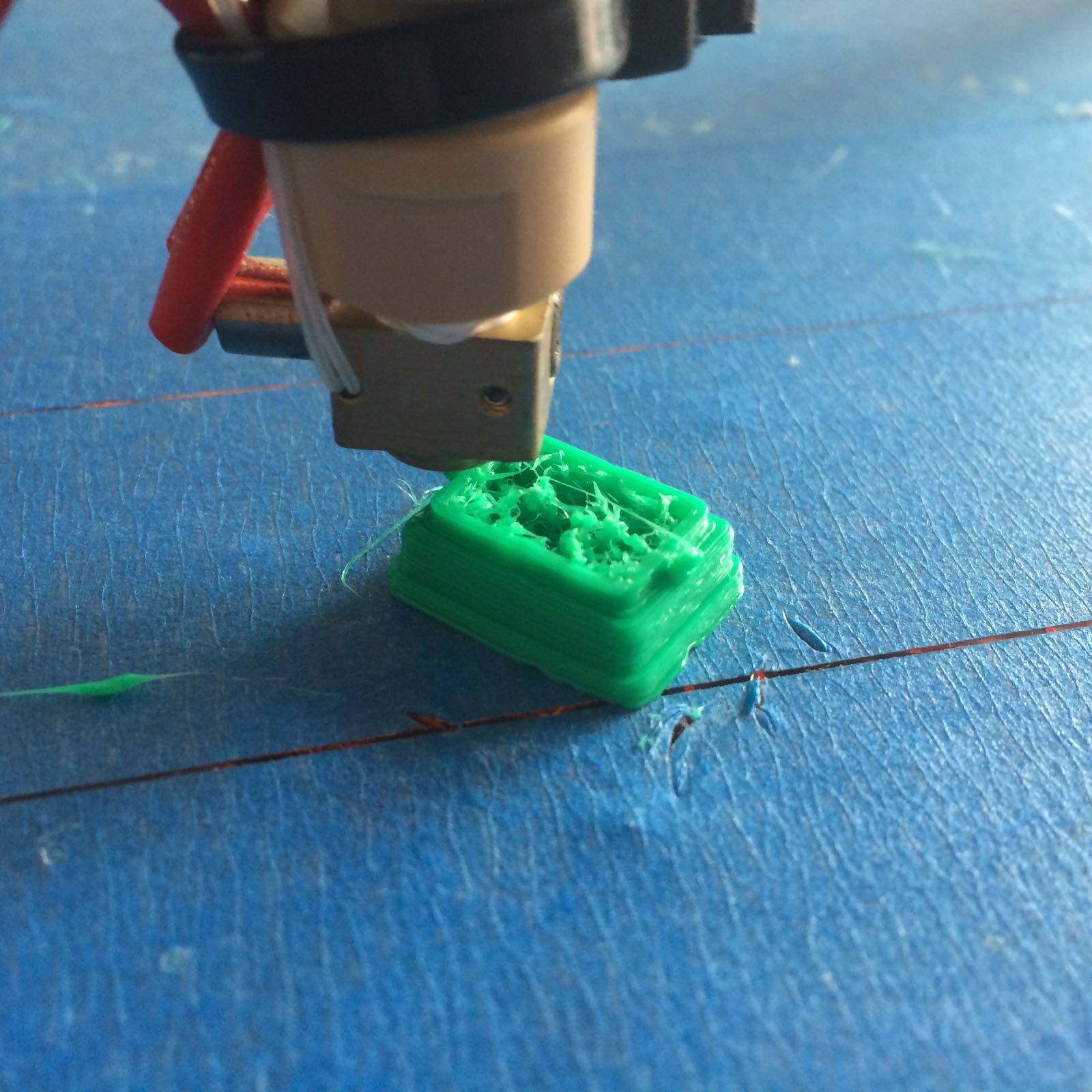

Hi guys, here’s a friend’s print.
What’s the cause of it screwing up?

It looks way to hot. If it is PLA the printed part needs cooling. Also check if extrusion temperature is correct.
If that is not sufficient i would lower speed to see if it improves the print.

@Bjorn_Marl , I am getting the settings from my friend. Thank you
@Scottie_D369 , bed is level, as I have seen it.
Even if bed was uneven, it should not result in the lumpy result when printing the infill.
It’s a Deltaprintr, on fishing lines, no belts.
F/w is updated. Calibrated.
It’s not mirror glass. It’s acryllic.

ok then there “could” be a clog somewhere?
Retraction is also bad
such small parts need to get cooled well. Easiest way to achieve this: printing the same part 2 or 3 times more simultanously.
@Bjorn_Marl , the print temp. was 180 deg., no fan as the Deltaprintr has no fan.
@Rene_Jurack , good point, I agree.
If you have access to a proper thermocouple check the temps. I had an issue with the hotend that originally came with my printer where the temps where out by about 15 degrees, once I was aware of it, it was just a matter of taking into account.
@Ivan_Hoe j ust use a household fan
All comments about heat good, but maybe also change some infill settings. (edges look “ok”) Maybe also try rectlinier instead of the large honeycomb. I get problems like that when I use low infill and honeycomb.
Speed comes with a cost, the layer underneath is not cooled enough for the next layer to be deposited, and not enough retraction might caused pot holes that obstruct the next layer to be laid down flat and perfect, increase the amount of infill, or slow it on the infill (you should decrease the speed on small perimeters too, it might jitter about)
Take your speed down to 25mm/sec and try again. If it looks good, increase by 5mm/sec and try again. Speed can cause all sorts of issues. And if you are not using a cooling fan, get one.
