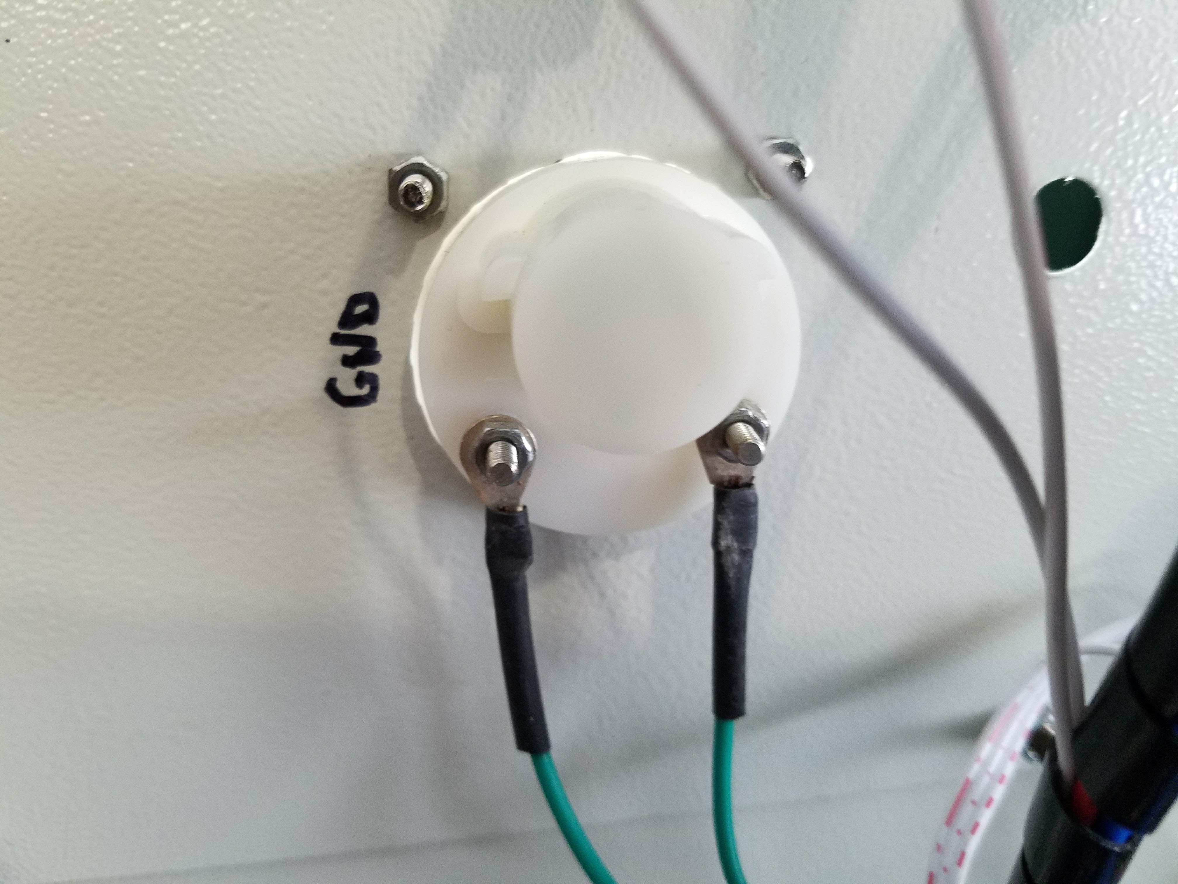

Here is how mine is connected.

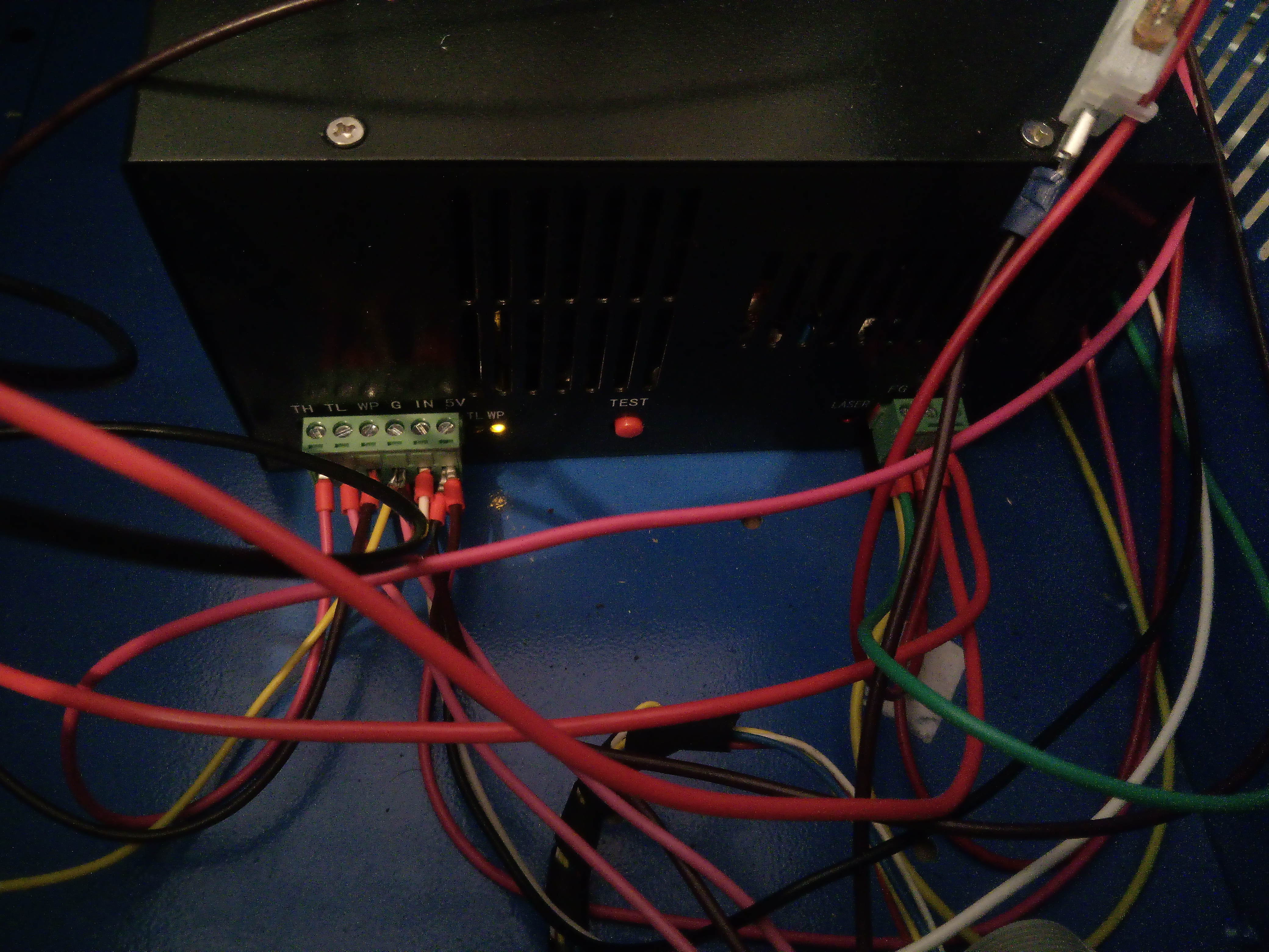

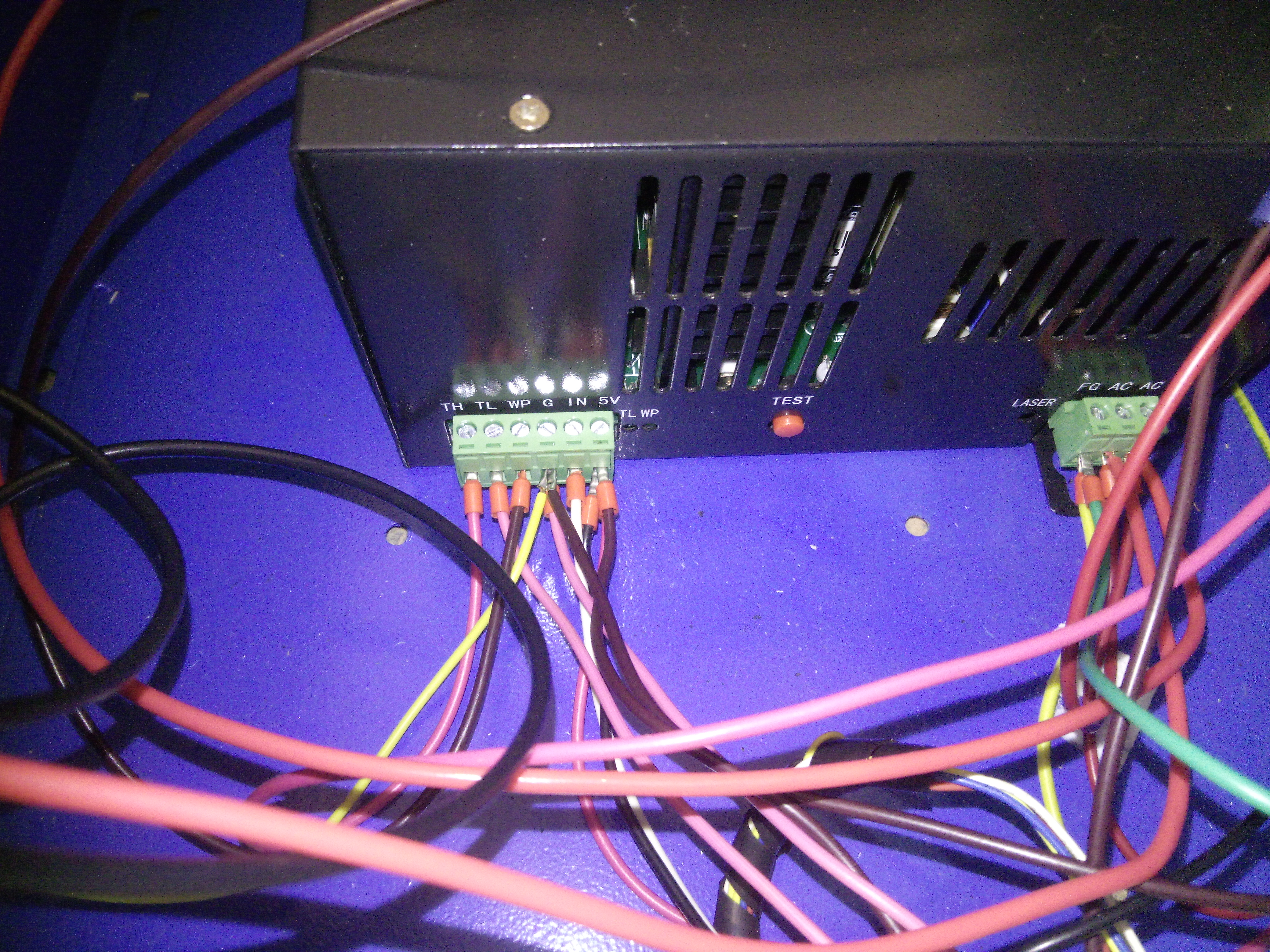

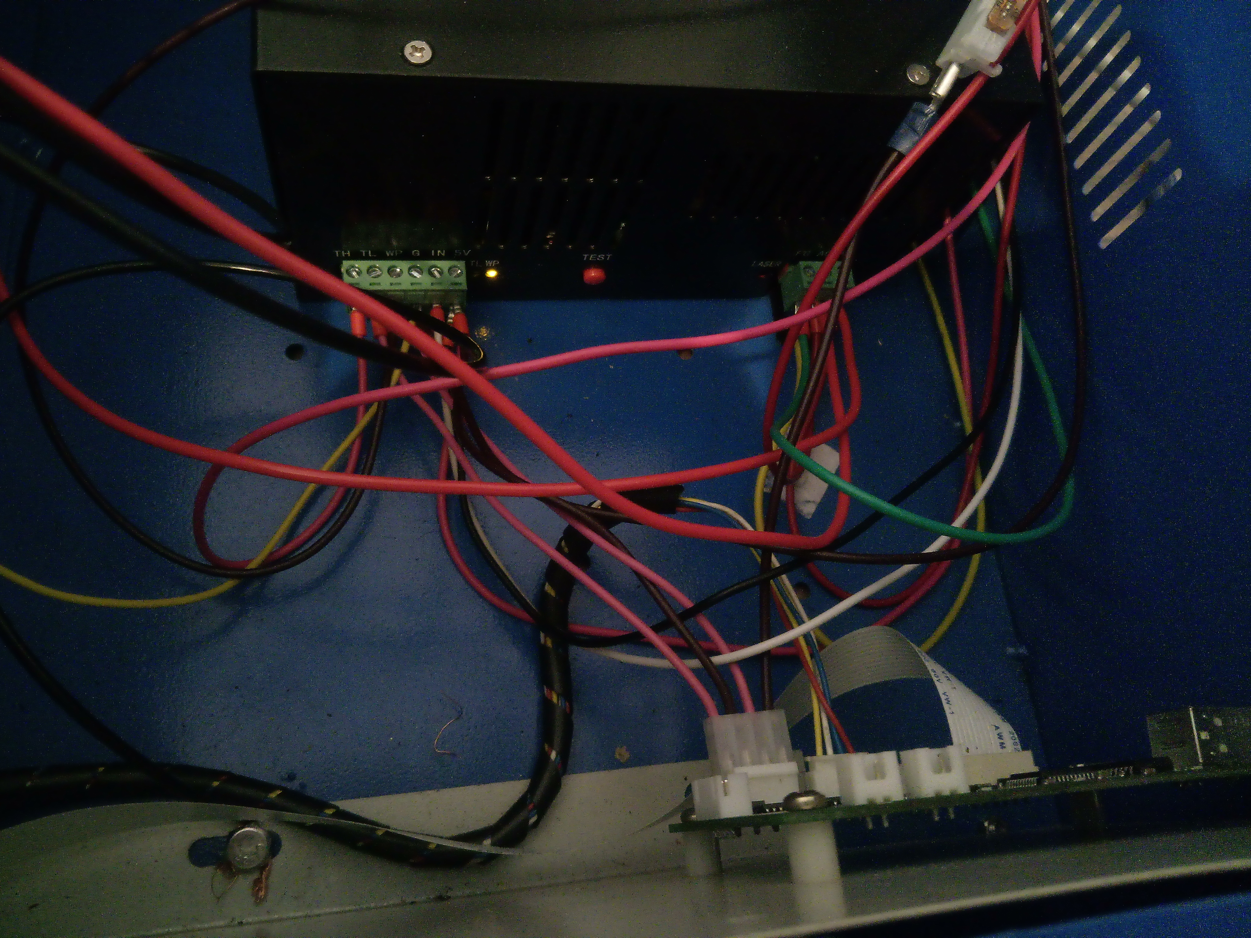

Hi again Don , sorry I was away with work. Back to annoy you again lol. By main PSU I mean the new one I bought. The large black one for the laser. I am attaching pictures, if you notice on bottom left there are 2 holes marked TL and WP. When I press laser switch on control panel the WP lights up. Then on the bottom right of picture there is another led marked laser, When I press laser test on control panel the laser led lights and the WP led dims. Hopefully you can see that from the photos. I also checked on the nano board and it is getting 5v and 24v

B1 - main PSU being the new large black replacement. The fan inside is coming on but no LED’s lighting.
B2- wp is an led on the power supply as in photo.
B3- laser is another led to the bottom right of the power supply.
B4- I measured on the board itself using ground on the board and 5v and 24v and getting voltage ok .
B5- tl is another led on power supply. Directly beside wp led. Shown in photo.
