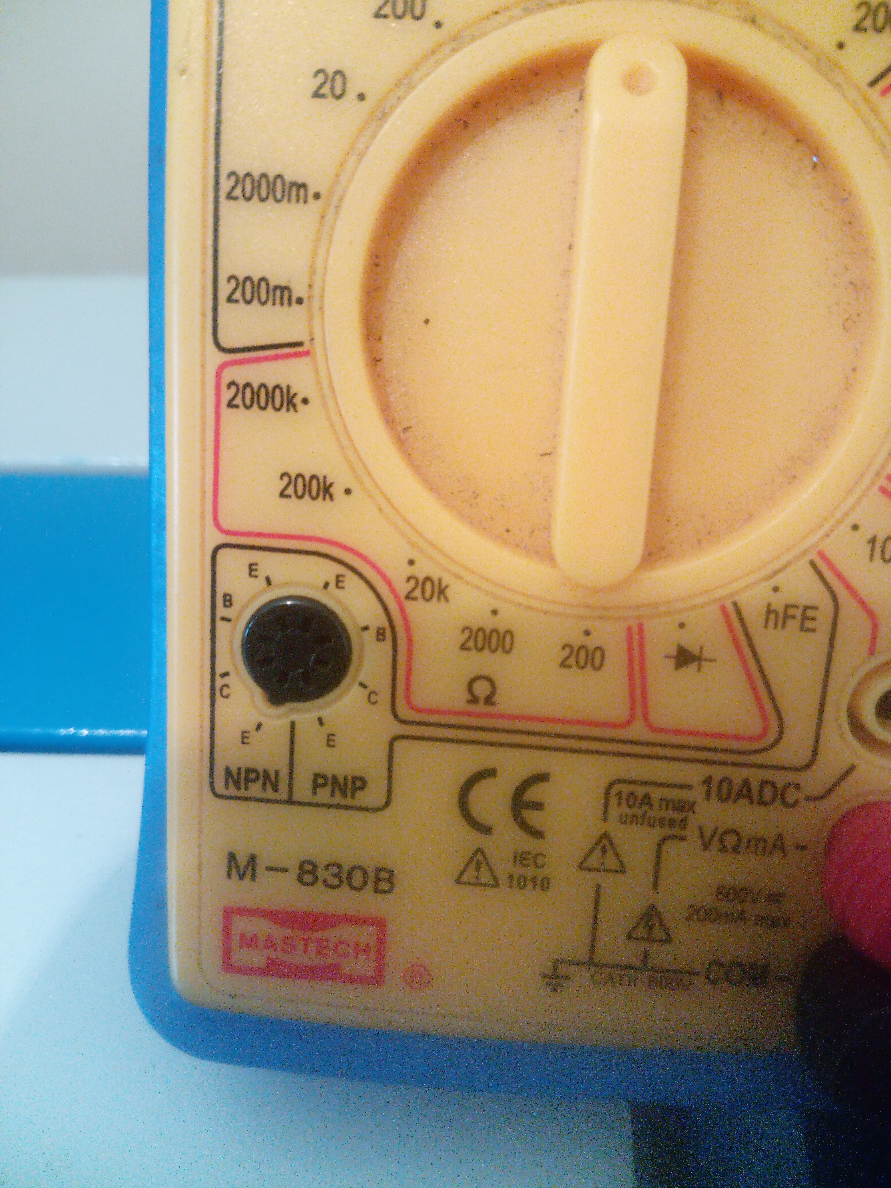

1.0 with machine off measure OHMS from LPS gnd to chassis.
@Jason_Farrell anything I can do to move you forward to a solution?
Sorry don , only getting a chance between work. I don’t know if I did it properly but took readings.
200- bat
2000- 983
20k- 0.99
200k- 01.0
2000k-001
I attach photos, I took readings between fg on power supply to chassis.
