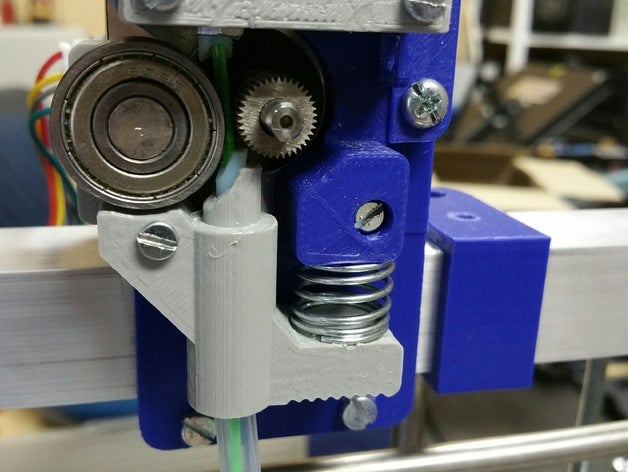

I did one a while ago with connect-it and 19mm tube. I have all the designs for it. I’ve since changed subsequent printers to 25mm tube and it’s a much more refined design but the upgrades can easily still be used on the 19mm design.
On the subject of bowden. I posted a design for an extruder on thingyverse and youmagine that works as both direct and bowden.
@Michael_Scholtz Thanks , do you mind giving me a link for your extruder.
Thanks for help
Thanks @Michael_Scholtz you star. This most defiantly will help. Now to start printing the parts for the Printer
