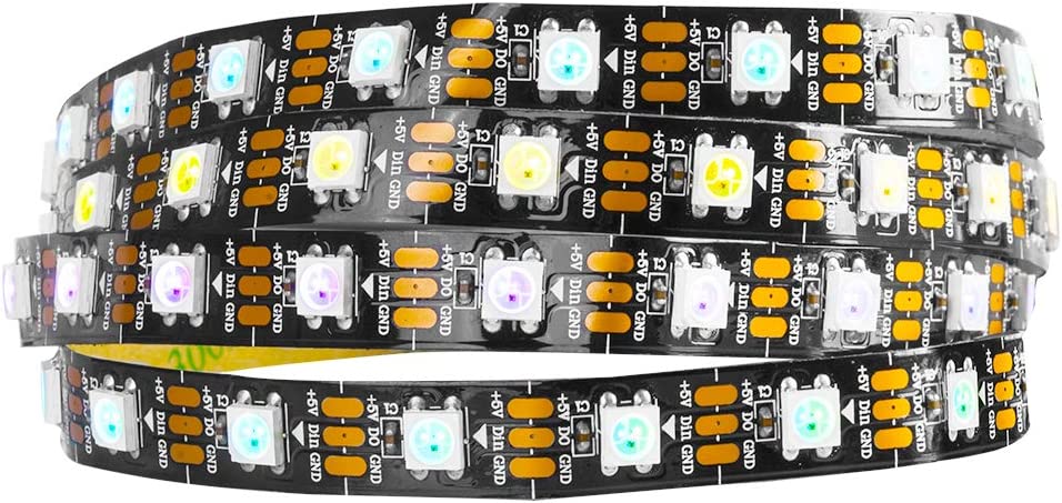

I have bought some WS2812B LED strips in order to a DIY ambilight for my monitor. The problem is that for some reason the lights won’t light up how I expect them to. It looks to me like there is something wrong about the frequency or something.
What I have done:
  • connected the arduino nano to my pc via usb
  • the LEDs are connected to it via the digital pin 5 with a 470 ohm resistor in between
  • LEDs have their own powersupply with 5V 8A
  • arduino ground and LED ground are connected to the powersupply

These are the LEDs I’ve bought.
You can take a look at it here:
