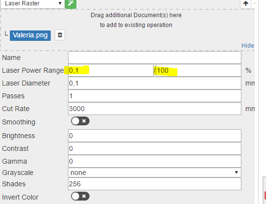

Hi guys,
I don´t know what exactly is the behaviour of the field “Laser power Range” in LW4.
At least for me, if I put a value in that field 0,1 i.e. I´m expecting the other field “/ 100%” change automatically (even when you can´t see the other input if you don´t resize that menu).
I mean, I have to change both in order to the generated gcode works fine, it seems the 100% field, is the field LW4 is taking for generating the gcodes.
(I´m using it in a Laser raster operation).
is it that the behaviour? I´ve to change both?
“/” between the fields is misleading. 1 / 80% is not 0.8. @Jorge_Robles
Should be “to”, yes. I will fix next commit

Ok, now i know how it works, min to max

Now another question, if I want to engrave always as the same level of power, I can´t make 5 / 5% because of generated gcode, i think is not correct, at least, it does moves, but not fire the laser (having a look to gcode).
I need to entry minimum between two values, 5 to 6 %.
Is it right?
You probably need to use an image editor to convert the image to pure black and white (no greyscale) then use 0 to 5%.
@Todd_Fleming Perfect!! Thanks for the tip
@Antonio_Garcia Being able to set the min and max laser power settings allows you to achieve the best contrast from your material. If you material is not affected below 5%power and it is also fully blackened at 60%power, then you would use a min-max of 5-60.
