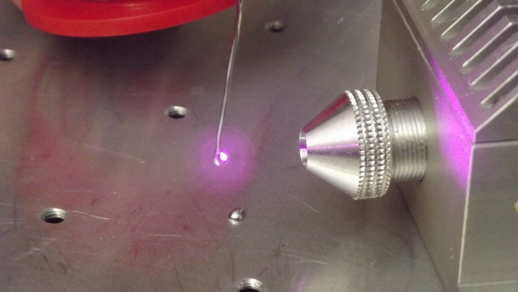

Yes, I did not pay anywhere near that! It was $250. I ran some tests to try and find the best focus spot, but I think I ended up closer to 18mm. I will go back to 14mm and try again. I just made a mark on the lens bezel, and ran tests rotating it in and out different amounts until I found what looked the best. Do you have any recommendations as to a method to find the ideal focus?
On my diode focusing is done as follows: use a white cardboard, place the diode at the listed distance. Turn on the sales to a very vey low power and the focus ( rotate ) until it’s shows a very sharp and clear small rectangle
Thanks Ariel - that’s the first I’ve seen that technique. It seems much better than my process! I’ll give it a shot tonight.
Dumb question, but my diode is invisible, so I can’t see anything until it starts burning, so I guess your method won’t work?
Well :frowning: do you have some special protection glasses?
Yes, I have the correct glasses, but I can’t really see the laser focus until the cardboard starts burning. I went ahead and focused it at the point where it starts burning fastest, and I seem to be getting better results. Thanks for your help.
808nm is near infrared, so you should be able to see it with a webcam or the camera of a mobile phone.
14mm focus distance is very close. This means the correctly focussed spot is very short, so the part has to be in the exact distance for the whole engraving area to get a clean engraving.
Thanks for the webcam tip Claudio, I can see the spot with the webcam. Unfortunately, it really doesn’t seem to change as I rotate the focus tube. There is a small dot all the time, and when I turn the power dial all the way down and press the manual fire button, the picture on the webcam is still to bright to see much of a shape, and focusing doesn’t seem to change the shape. I’ll keep fiddling and see if I get anywhere. Thanks again!
You must keep it on while turning to see the change. Just go to settings and there is a field for the test button. Place a very small value there until http://you.see it
Ariel, Thanks, I’ll try that.
