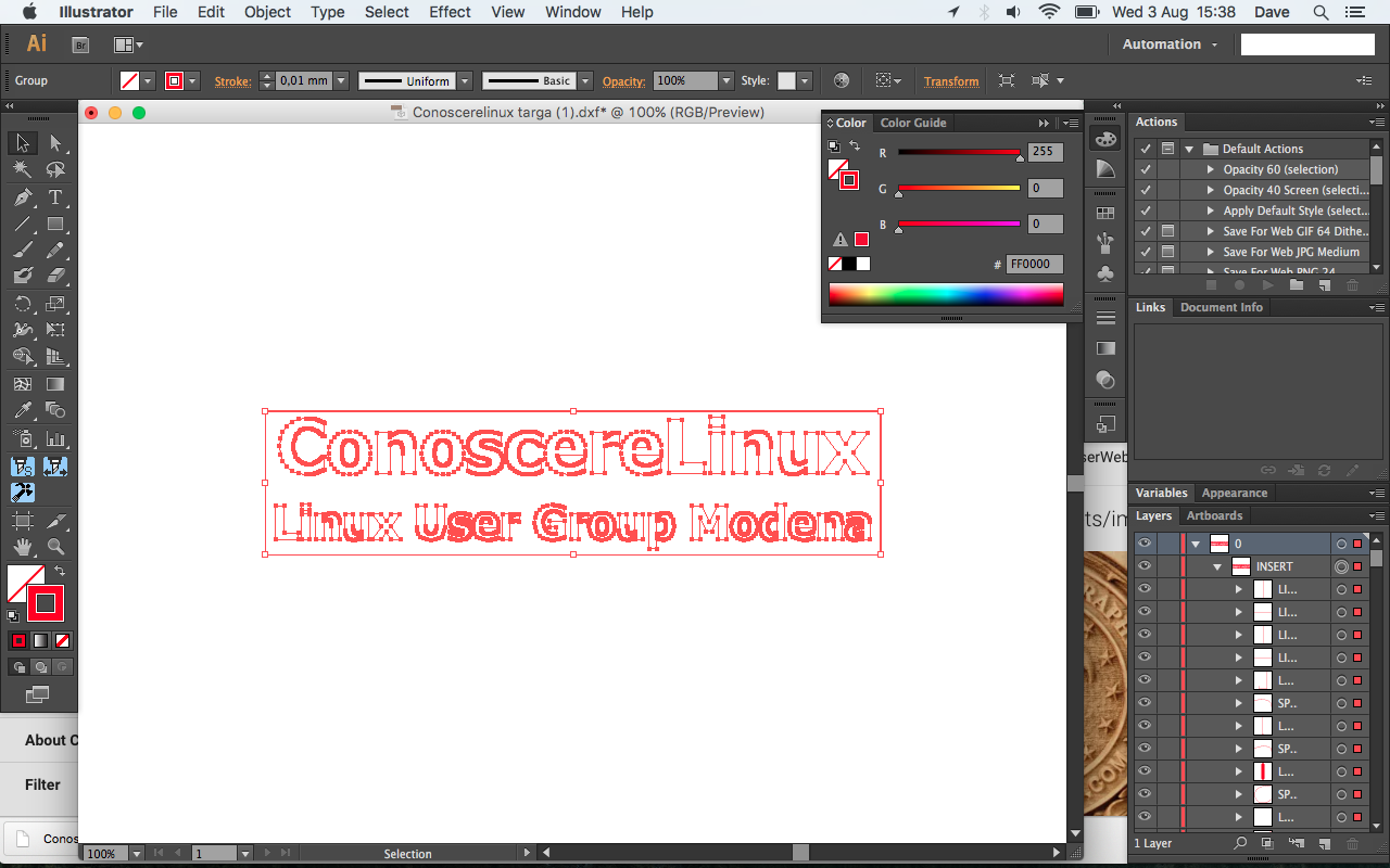

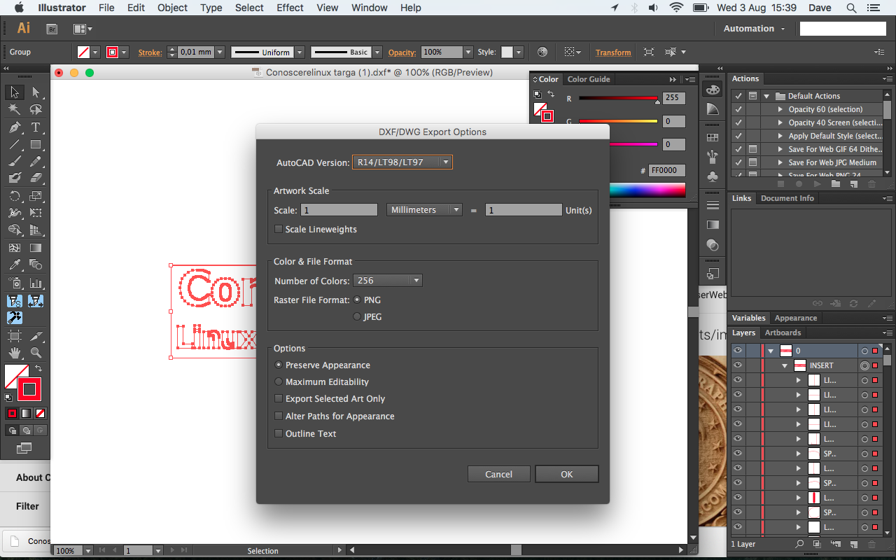

Hi guys, i have a problem with DXF made by Illustrator.
When i try to load this file on LW3 it do not show nothing.
I gave you the file and a couple of screenshot.
File: http://www.filedropper.com/conoscerelinuxtarga1
Thx, now cut well.
