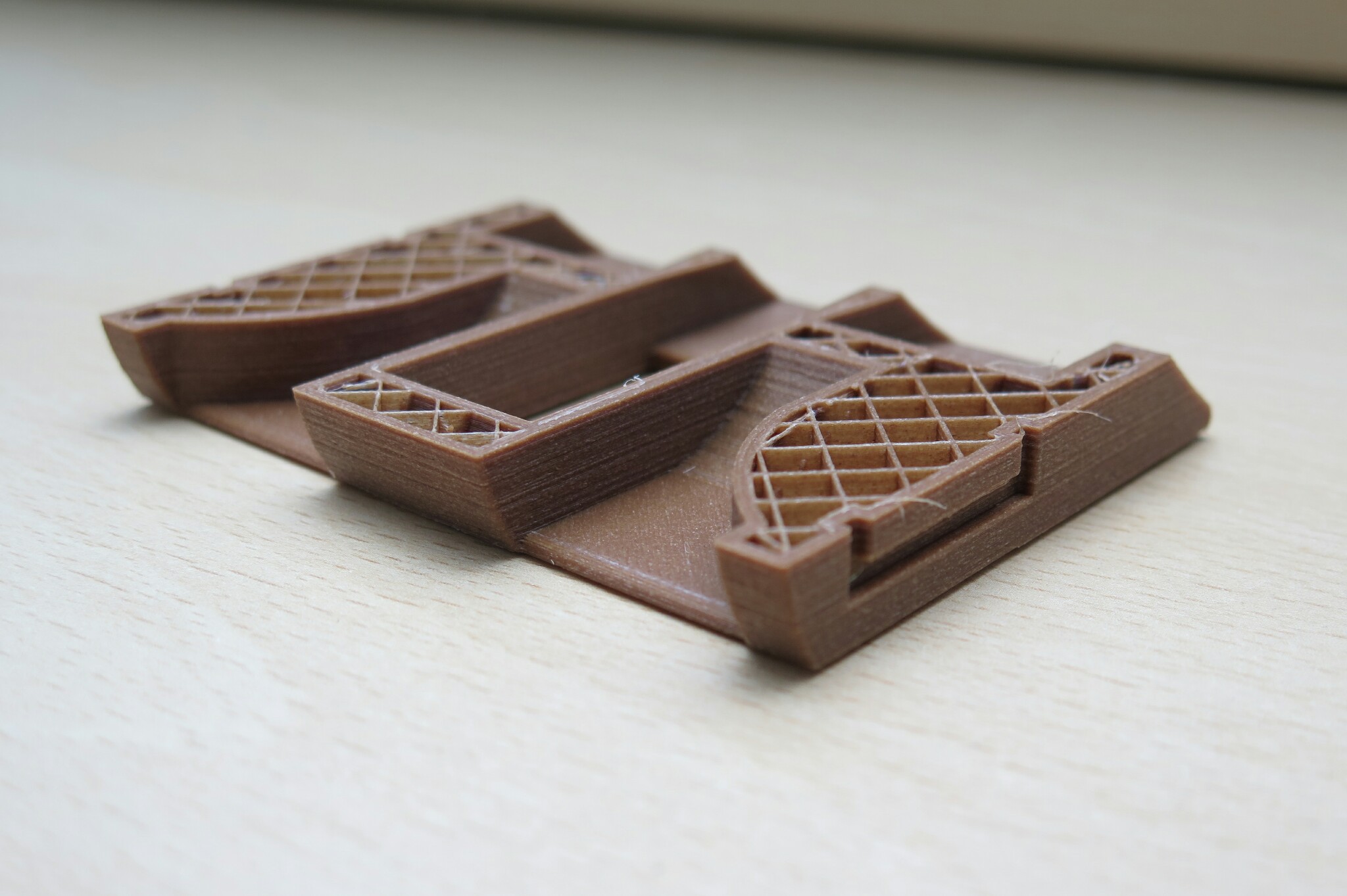

Hi guys, I have a problem with my Prusa I3 Hephestos.
Hi guys, I have a problem with my Prusa I3 Hephestos. Using SainSmart’s laywood, often the layers aren’t welded correctly so they detach themselves easily.
I have this problem only with SainSmart’s laywood, printing the same .gcode with other filament, I have no problem.
I sliced my STL with Cura: layer0,15-temp215°

I would try going up in 5 degree steps. Its going to be trial and error until you get it right. When I get layer bonding issues with almost any filament it’s usually because it’s too cold.
Ok, let me try with 220°! Thank you
Try thicker layers too.
Now I’m trying the same layer at 230°

now 50% and the print is fine…good luck to me :sweat_smile:
