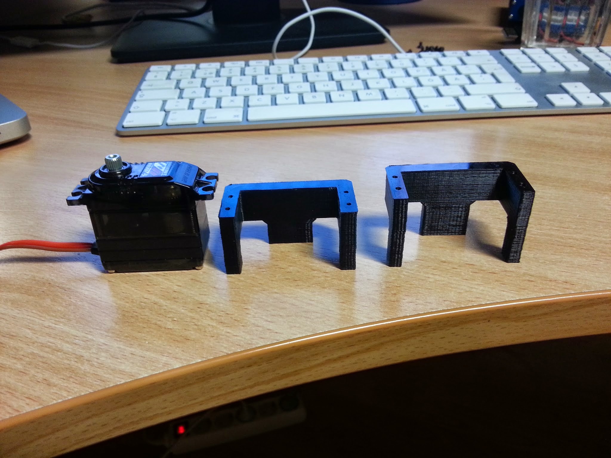

I have a question regarding the servo mount. I’m using suggested BMS-620MG servo from HobbyKing. There is no way it fits into the servo mount. Inner with of the mount is 39.5mm, servo is 41. Height of the mount is 27mm, servo is 32mm. Am I missing something here?
I modified the mount, made it taller and wider to make it fit (on the right).
Either the STL never got updated, or there is a couple of them. I don’t recall which. I’m pretty sure the .stp file of the mount is the proper size though.
I took it from the STP. Check the one with holes (older) and the newer which is printed here on the left. Their dimensions are the same.
