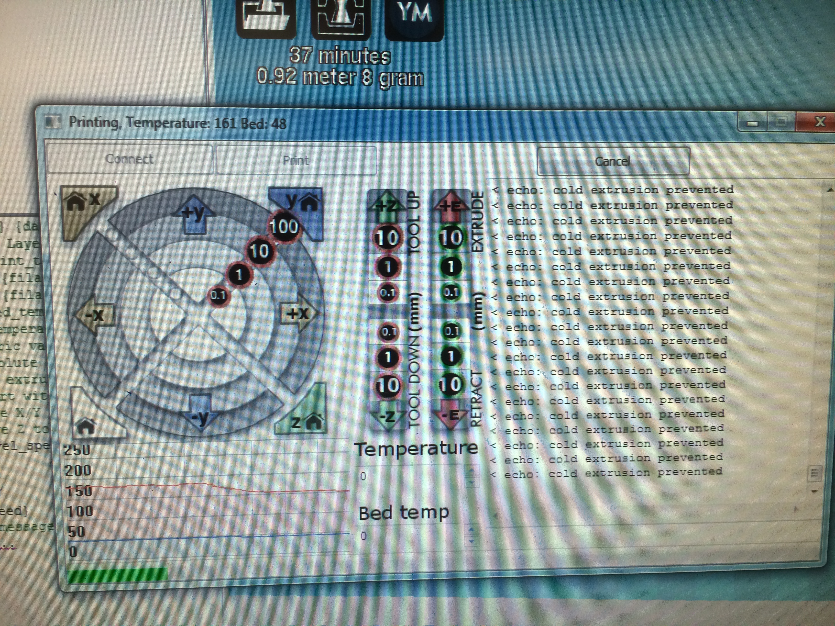

Hi guys i have a velleman k8200 and i use cura the latest version.
Hi guys i have a velleman k8200 and i use cura the latest version. I used to had problem with me heated bed and i changed the thermistor and now it is working. I also used to had problem with leveling but now im using glass bed and it is much better. So the problem now is that when the printer starts after 5 min the temp of extruder starting to fall.and i have a image like that.any ideas??

Yes there is a fan that is working but there was before.one thing that i want to check is if the thermistor is stabilized with the screw. The thermistor shouldnt had connection problems because in the start it measures ok.

The thing that’s weird here is that this is the temp as sensed by the thermistor, which is also responsible for controlling the extruder heater circuit. So as soon as the temp starts going down, the heater should be going full blast to compensate (unless there’s something in the g-code or the firmware that lowers the setpoint, which seems unlikely.) Is it possible your power supply just isn’t up to the task with the addition of a heated bed? Other possibility is that the extruder thermistor is faulty or just is losing good thermal contact with the extruder body and not registering the true temperature.

Yes the screw that holds the thermistor was a bit loose so it was doing that.one tiny screw was responsible…oh 3d madness!!lol thanks guys for your help!
