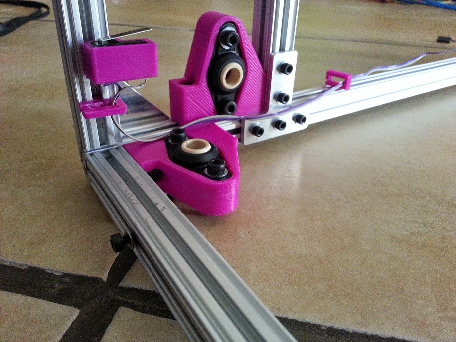

I’m building a printer similar to the Ingentis/Eustathios, but using OpenBeam (only extrusions I could find in South Africa when I started the project).
At the moment I feel somewhat stuck as I can not seem to find perfectly straight shafts anywhere. I’ve tried companies here in South Africa, and overseas (Makers Toolworks and igus) but all the shafts that I have received to date have had a slight wobble in them. This might not have been such a big issue if the shafts were static, but since they rotate (to facilitate movement in the X and Y directions), any flaw is magnified and you can literally see how the XY blocks move up and down when the shafts turn. Have you had similar issues? How did you address it or where did you get your supplies from? (a supplier that will export).
