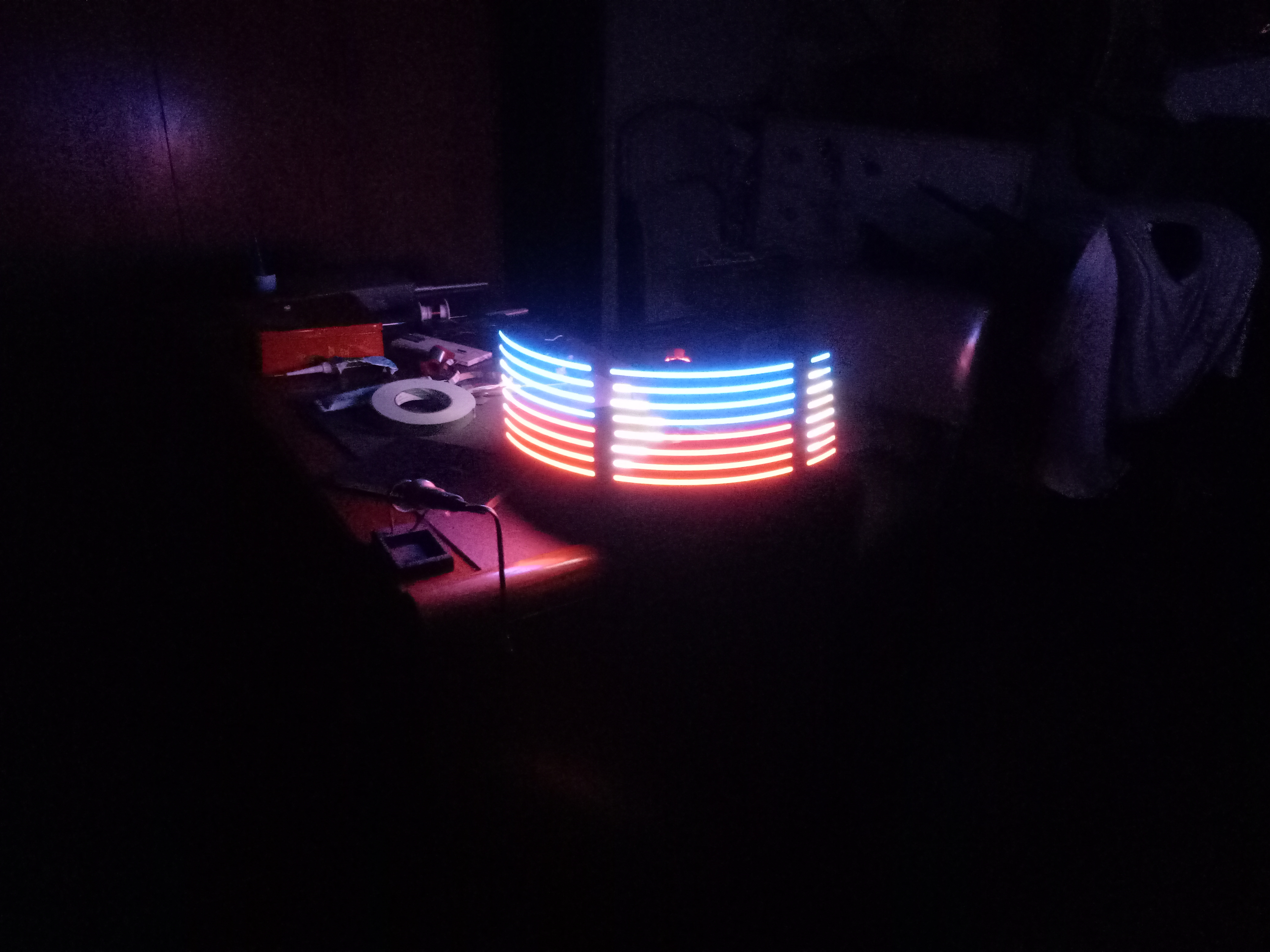

Hi guys i need help doing a simple pov function the problem is the (i) Leds scrip on the voild loop is making it too long. Needed help converting into array functions
LEDS is ws2812b on a Promini
Ideally for POV displays you should use a faster LED type, such as APA102, and using a faster controller as well, such as a Teensy 3.2 (96 MHz) would also be good. The LED type WS2812B is not that fast, plus the Pro Mini is either 8 or 16 MHz (depending on which one you have) so the combination of these is not ideal for a POV setup. You might still get something to work though depending on what you want to do and your setup. No harm in investigating that first! Your image of what you have going so far looks very interesting.

You can use a ProMini to drive a POV setup (I’ve done it, running at 16MHz, driving 4 strings), but as Marc said, you need faster LEDs. Those WS28xx LEDs are much too slow, unless you don’t plan on moving very fast.
@cliff_co Do not forget that the time to refresh set of ws2812 is nbleds * 30us. Hence for instance 600leds takes 18ms to refresh =>55FPS Max. On top of that you have your code running and as @marmil said, on a slow board the total FPS can drop really fast. POV will need at least 50fps.

This is a 10led setup x2 on both arms running parallel
@cliff_co that is really cool !!!
