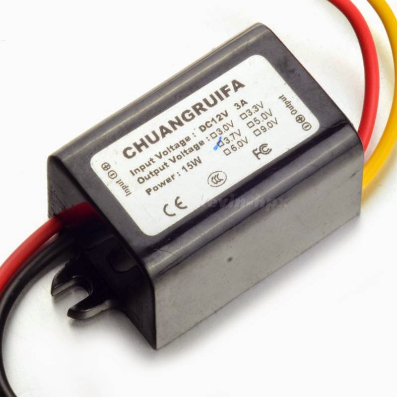

Hi, guys i need some help yet again. So last time you helped me figure out that i wasn’t providing enough power to my strips. I tested and confirmed that theory. My questions is: How many amps can i get from 8 AA batteries? That would produce 12v (which i need for the circle WS2812 LED (12 LED total)) and then i plan on using a 12v to 5v converter (pictured) to power the 5v ws2812 LED strips. (My arduino nano runs off 5v BTW) Would this work? I need about 3 amps from the 5v and barely any from the 12v. I need to use batteries for this project so if that doesn’t work, can someone propose a better 12v/5v solution?
That converter that you have pictured is marked as 3.7v - have you checked the output of it to make sure you’re getting 5v?
Also, how many leds are you running that you’re pulling 3 amps? The total number of amp hours available to you is going to depend on the type of AA batteries you use. If they have 2.2Ah, and you’re really pulling 3 amps, you’re going to get about 40 minutes of life, if even that. (Are you figuring a peak power draw or is this a measured draw?).
Yes, im sure the one i have is 5v because mine is marked for 5v. That’s just a stock picture from ebay of the item i purchased. I’ll be using about 240-280 LEDs. So running off of 8 AA would work with the converters and all but i would just have short battery life? Is there a better solution? i plan on using 175 as the maximum brightness for the LEDs, i avoid using white as this is mostly colorful. This is basically what im building: https://www.youtube.com/watch?v=FHJeidIXR8Y
