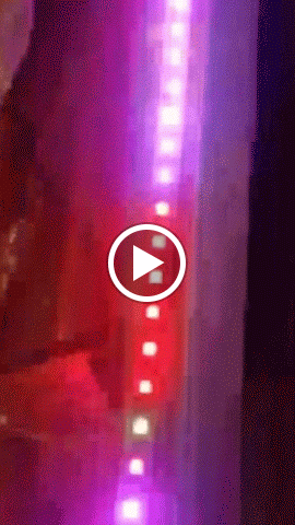

Hi guys, I need some some help again. I’ve been using the digispark for a while until Mark pointed out that i need a more powerful board to light 5 meters of LED strip. So i got myself an Arduino Nano clone (http://www.ebay.com/itm/121480535048). The problem i’m having is that when the strips light up, they flicker like crazy, it looks like they’re having a seizure or something. It looks to me that they are lighting up white in between each color they want to produce. The code i’m using is the FastLED Color Palette Example. The Color Palette Example code works just fine on my digispark clone (once i add the line: volatile unsigned long timer0_millis = 0; ) but is totally out of control on the Nano. What’s the problem? Am i uploading wrong? Is something wrong with the code? (highly doubt it) Is the board just bad an i should get a different one? When uploading i have Arduino Nano ATmega328 selected under board, and Digispark under programmer. (Someone told me it doesn’t matter what i have selected under programmer.) The serial port is also correct because my uploads go throu. Can someone please help me. Thanks in advance.

I think i figured it out. It was a power issue likely due to uneven power. I detached the other 4 meters of LED strip and the white blinking was still there. I was powering my NANO via a usb power bank from the usb port at 5v 1a and the LED strip from the 2wire 5v 2a dc thing. What fixed it was powering BOTH the NANO and the LED strip from the same power source, so the 2wire 5v 2a dc thing. I’ll try it later with the full 5 meters later.
