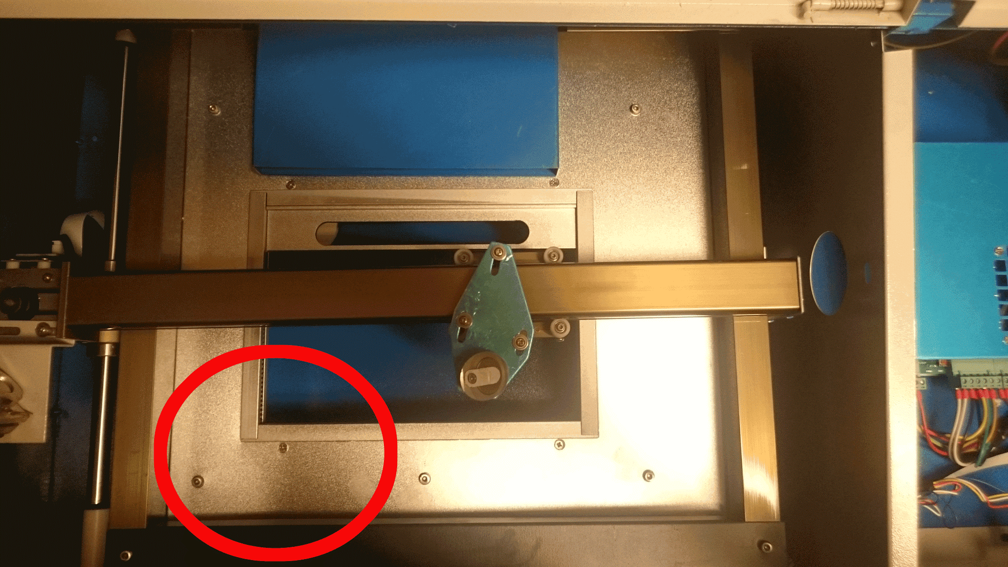

Hi guys, i started asking around here this spring and I finally joined the K40 owners club this Friday. However when I unboxed it today, it was not in working order as I have seen many of yours aswel when delivered. Here are some photos of the problems in the bed-area. What do to do correct this, how much of an effort? Where to start (I have already stared a case via e-bay ).
I would gladly recieve some feed back from yoe experienced users in these areas.
  • Bed bent
  • Y-axis rod does not line up square
  • Y-axis rod has a deep scratch close to the home-end stop
  • The 3rd mirror& lens holder is loose and one for the bolts has snapped off.
Please advice!
Cheers
/Micael

The bed you’re likely to toss pretty quickly so no big deal. The Y-axis misalignment is typically although yours is more apparent than most - easy to fix by slipping the belt a couple of notches (you could do that while removing the bed & exhaust duct). The carriage mount is a bit harder to deal with. The standoff is readily available (Amazon carries them or eBay - they’re called PCB standoffs & I think they’re like $3 for a bag of 10). The trouble is you’ve got to get the existing stud end out which will require a drill & extractor.
I’d also check the wiring to see if something was disconnected and keeping it from working. You can do all that while waiting for a refund or a payoff from the vendor.
If your damage was caused by the accessories crashing around loose in there (fan and pump) the carriage is likely bent beyond salvage, I made one, but they’re readily available. Here’s a link to a reputable parts source that also has competitive prices.
You may as well order the complete carriage and air assist head, it’s probably where you’ll eventually end up anyway.

Take a video and point out all the stuff that is wrong with it… they will request a video for any type settlement
Also inspect the laser tube and look for any signs of cracks or disconnected wires from it
