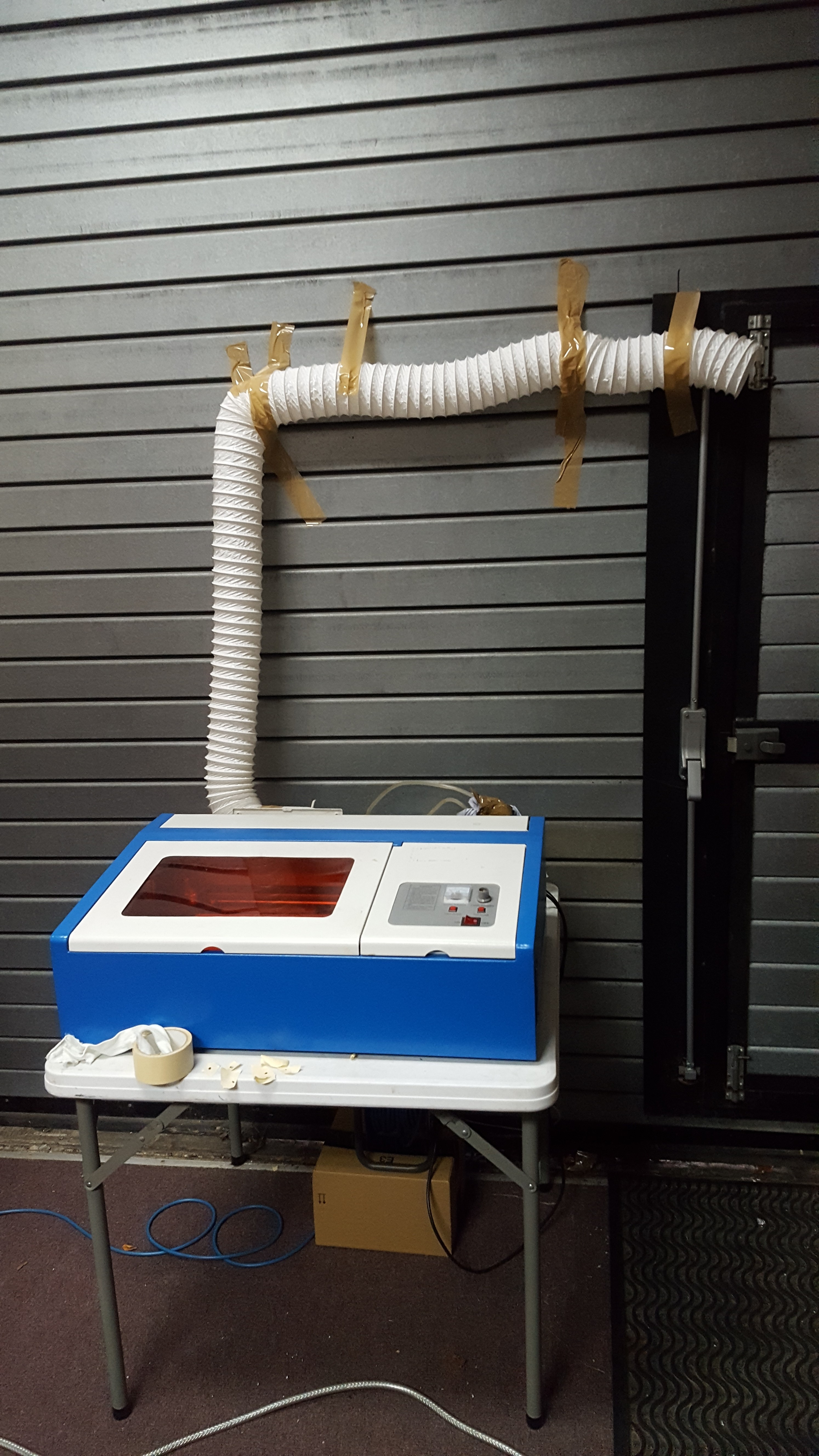

Hi Guys, I wondered if anyone could help me.
Hi Guys, I wondered if anyone could help me. Im trying to locate the Drivers online for the K40 printer. I been given the task of set up but the fundimental memory stick is missing.

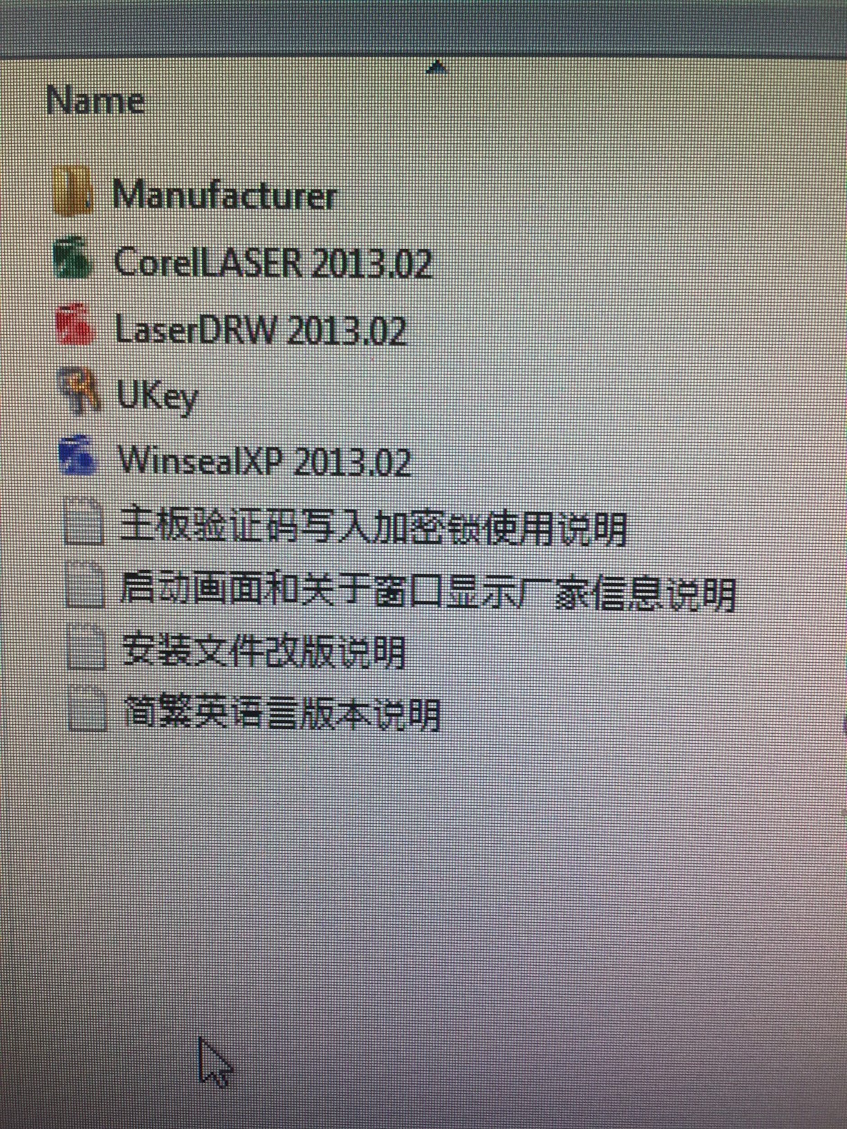

Thanks for your help - I have managed to find a download link for various bits of software. It has the CorelLaser software and some other bits but still not having much luck. i have noticed there is a Ukey file though, i wondered if this is what i was after?

Right moshi boards do need a USB key but give me a little time and I might be able to find a dongle free version.
