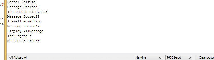

Hi guys ! I’m working right now with my project that the text message from GSM module will display on RGB LED Strip , I have conditions using text message ; View AllMessage , Delete AllMessage , Delete Message # ,Display AllMessage , if the textmessage is not the conditions above , it will automatically stored in a array (that the message that will display on RGB LED Strip)
But when i started to text Display AllMessage( display all message that saved in array) and text again some message it only read 12 characters in my text . Are my arduino is too busy to display message in RGB Led strip so that when i text again it only accept only 12 characters ? help me guys the code is below . And i uploaded pictures , i texted 3 messages that will display on array , " The Legend of Avatar " and etc . then I texted Display Allmessage ( to display in RGB ) the 4th text is also " The Legend of Avatar " but it in serial monitor it cut on 12 characters only
