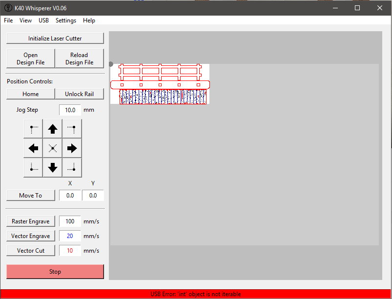

Hi guys, just tried to set up k40 Whisperer, followed the install instructions,
Hi guys, just tried to set up k40 Whisperer, followed the install instructions, for 7a, said driver was successfully installed, however when i try to intialize laser cutter, it comes up with this error? any ideas what the problem is?
It looks like you managed to download the windows 64bit executable that was compiled bad. Download K40 Whisperer again.
The bad version was posted for a few hours but has been replaced. The program code did not change so it is the same revision. The usb part of the executable was broken because it was built with the wrong version of PyUSB.
@Brendon_Todd ​ were you able to get K40 Whisperer to initialize?
yes, that worked great!!
