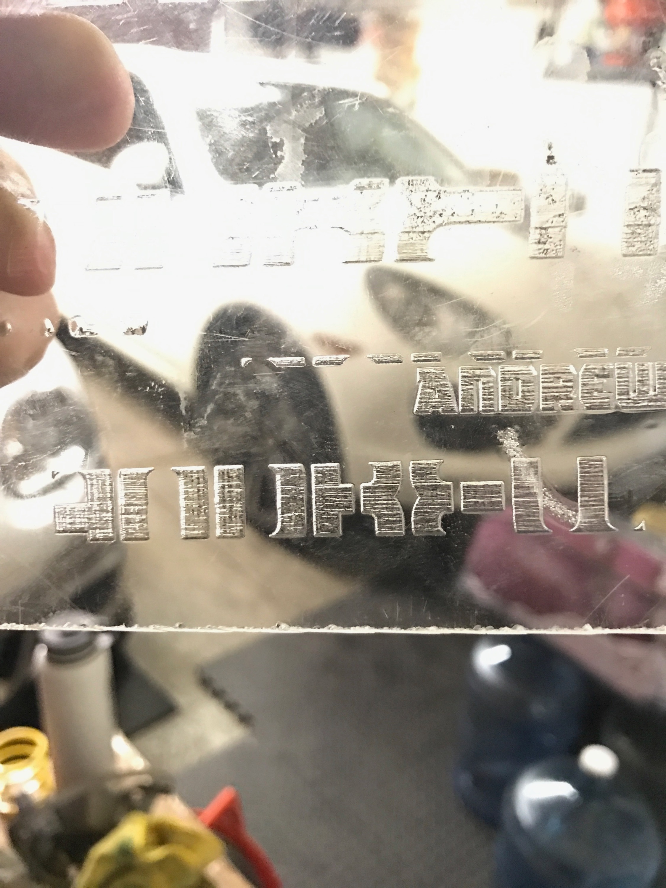

My k40 running Corel Draw X7 works fine. from time to time i use fonts instead of PNG files of TEXT. From to time. my font choice is completely cropped down when i am engraving and ill lose the product.
for example… if it words are 4 inches long and 1 inch tall…
the K40 will only zap about 3.5inch x .5 in tall.
I will only a cropped portion of the text.
Ive converted to bit map and also retraced it once its an image. im out of ideas.
it will do this on SOME but not ALL fonts i use in CorelDrawX7.

Is it cropped in the preview? Also what is an example font this happening with? What engrave output file type are you using?
Hi Ned, It’s not cropped in the preview before engraving its acts completely normal. When it comes time to zap… its cropped.
one example of a font is “OXIN”

I’ve zapped it as TEXT and as a converted BMP/PNG file.

I’ve had several fonts do this to me and I always convert the font to curves and they engrave and cut properly after that.
Jeff and ned, now its doing it to fonts that are just standard and that ive used forever. what gives?
I never tried to troubleshoot my font problem after I discovered converting to curves fixed it. Have you tried converting the font to curves? At that point the text should be seen as lines just like everything else.
