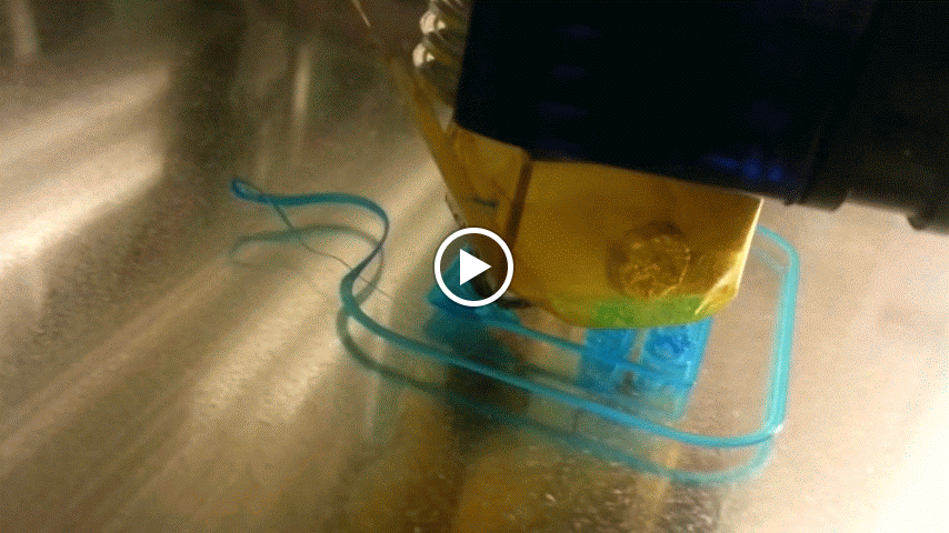

Hi guys, need help on this problem..printing PLA at 195,
Hi guys, need help on this problem…printing PLA at 195, 0.4mm nozzle 1.75mm all metal E3D. 0.4mm first layer height.
Am I over extruding? Bad z leveling? Or is this cause by the software?
This was with slic3r.
Seems like too low on z leveling. add 0.1-0.2 in slic3r and see how it works.
You’re overextruding slightly too. Notice how the filament piles up on the edges where it changes direction. That shouldn’t pile up a lot.
Slic3r got default 200% extrusion width for the first layer, isn’t that ‘wanted’ over extrusion?
Higher and it dosen’t stick on bed, that 200% is interresting, will try to lower it and see if it goes better, thank you
@Mateusz_Perlak ​, it’s not over extrusion for the first layer. The line widths are accounted for so that it’s not over extruding.
Thanks, so that means it will space the lines 2x more between them, not adding extra plastic?
@Mateusz_Perlak , yes, it spaces the lines apart appropriately, IIRC
Your layer height must be less than your nozzle diameter. I think the max is 80% of nozzle diameter. If its more, the extrusion doesn’t get squished down enough and maintains a circular cross section. It also men’s less bed adhesion and its path becomes unpredictable.
I had a similar problem. I changed the first layer parameters: layer height = size of the nozzle, in my case 0.4mm and set the width extrusion to 200%. Everything works great
@Enrico_Colautti This is actually my exact setup.
Again, layer height must always be less than nozzle diameter. http://hydraraptor.blogspot.com/2011/03/spot-on-flow-rate.html
The extrusion is unpredictable if it is same or higher. @nop_head ​ has great examples of filament shape and path on his blog. Because your layer height = nozzle diameter, the extrusion is not flattened down, and it doesn’t form a predictable shape or path.
@Stephanie_A Will test that too tonight even if i’m less optimistic.
@Stephanie_A is right. To get proper adhesion, your layer height should be <80% of your nozzle width. There are those who will claim that’s not true, but the result of anything over that is sub-par.
