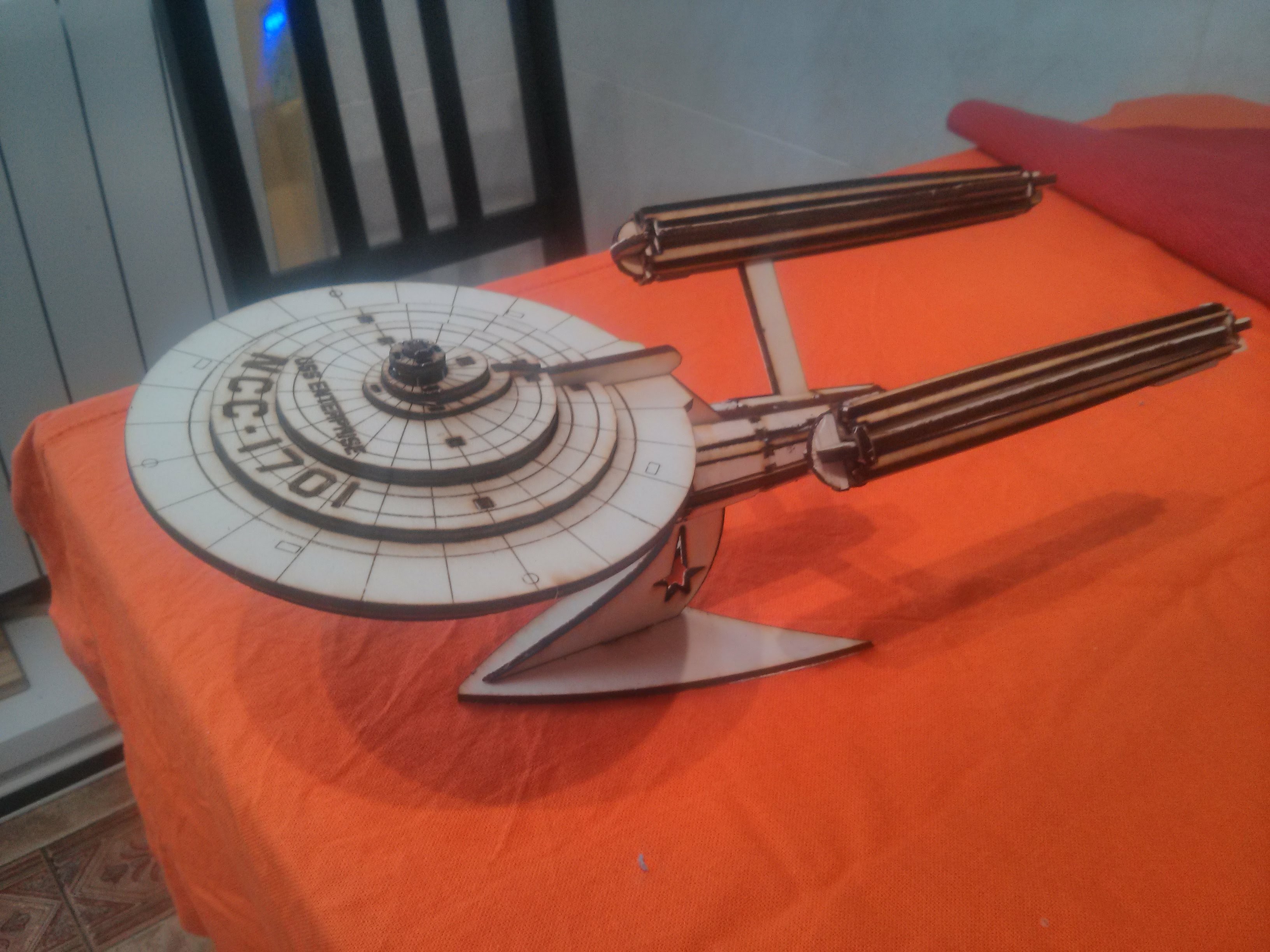

Hi guys.
USS Enterprise finished.
A hard work to make with a laser diode.
Gcode created with LW4, with some issues in the gcode file created.
Send to ramps 1.4 with LW3.
very good man, specially on a diode. Lots of patience
@Ariel_Yahni_UniKpty more than 5 hours to cut all the parts.
Files from here: http://www.thingiverse.com/thing:1902315
if some one are interested.
what wattage is the diode you used and what type of wood?
@Scott_Lewis 3mm plywood and the láser is 3w
