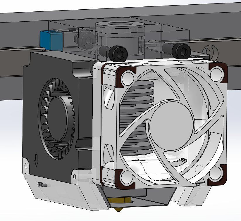

Hi guys. Working on a new printer design.
Hi guys. Working on a new printer design. Wondering what your thoughts are on 3mm vs 1.7mm filament. I have watched every youtube video and read every blogpost i can find, but some are 3-6yrs old in a rapidly changing market. I realize you can get nearly the same results with either size with a properly tuned setup. it looks like both sizes are here to stay but i’m not sure.
So my question is, should i design in 3mm or 1.75mm?
backstory:
I am a mechanical engineer. I enjoy designing and building the machine as much as printing itself. I realize i could build one of the already existing designs, but i want the enjoyment of trying something myself (fail or succeed).
current design parameters:
~200x200x200 build volume
bowden
E3D v6 hotend, maybe plated copper heaterblock
linear bearing rails for all axes
gantry style XY with Z moving up and down, similar to bcn3d sigma r17
noctua 40mm fan for e3d
2x 40x10 blower for part cooling
printing of pla->pc. so i guess topping out around 270-300c

It looks like your blower fan ducts are cooling the heat bed, but not the fresh extruded plastic.

@Gerald_Dachs thanks for the tip. this is still early in the design :D. was thinking something more along the lines of the UM3. still a WIP.
