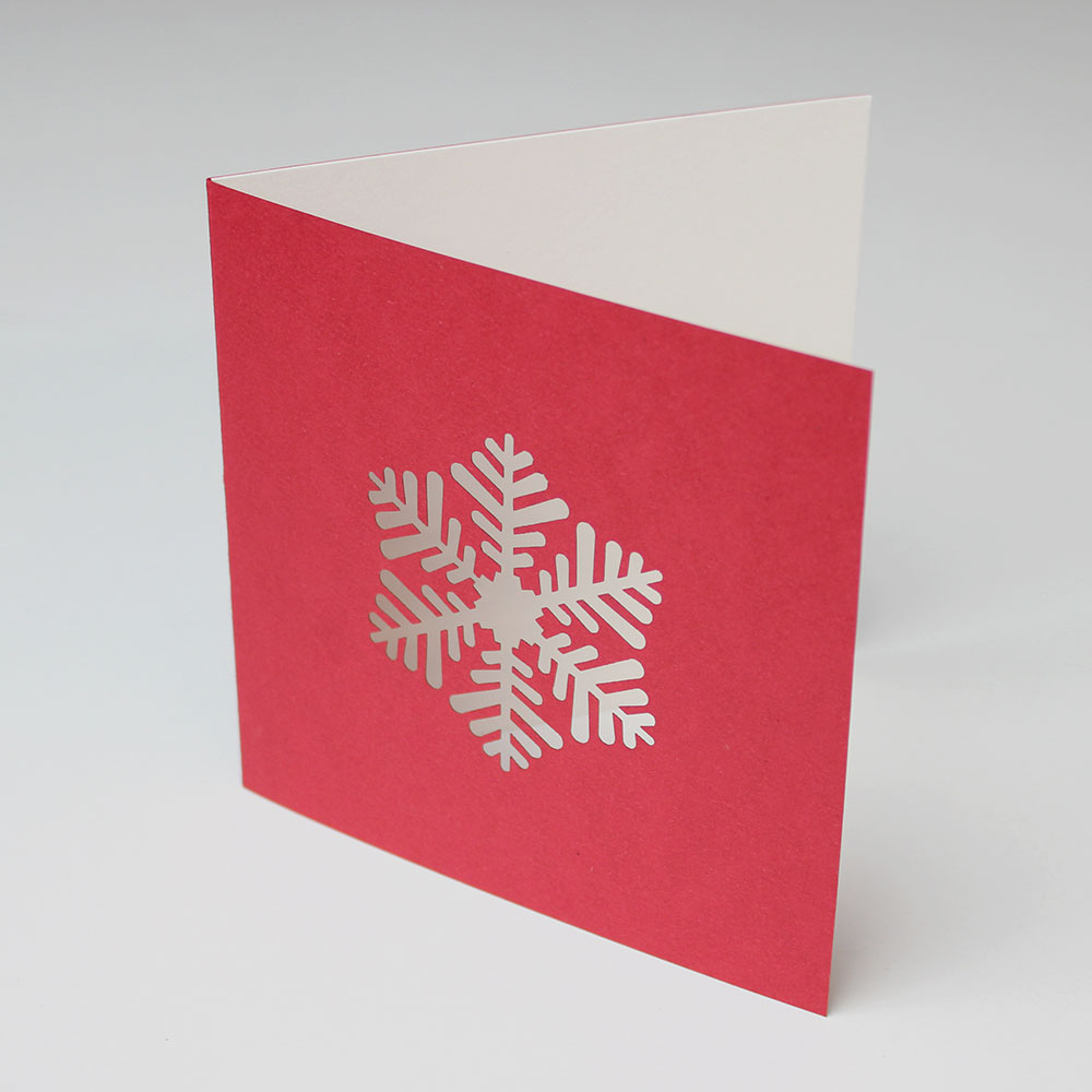

Got the K40 up and running with Don’s help fixing the y-axis sensor (thanks again!) - I’ve been cutting somewhat simple designs into 100lb cover cardstock - I uploaded a stock picture for a rough idea of the type of design I’m cutting.
