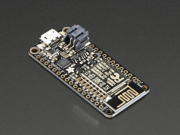

I love this one:
That’s a nice board, but I need 5v logic with the 16Mhz clock. I’m looking at the arduino micro with the atmega32u4 chip.
