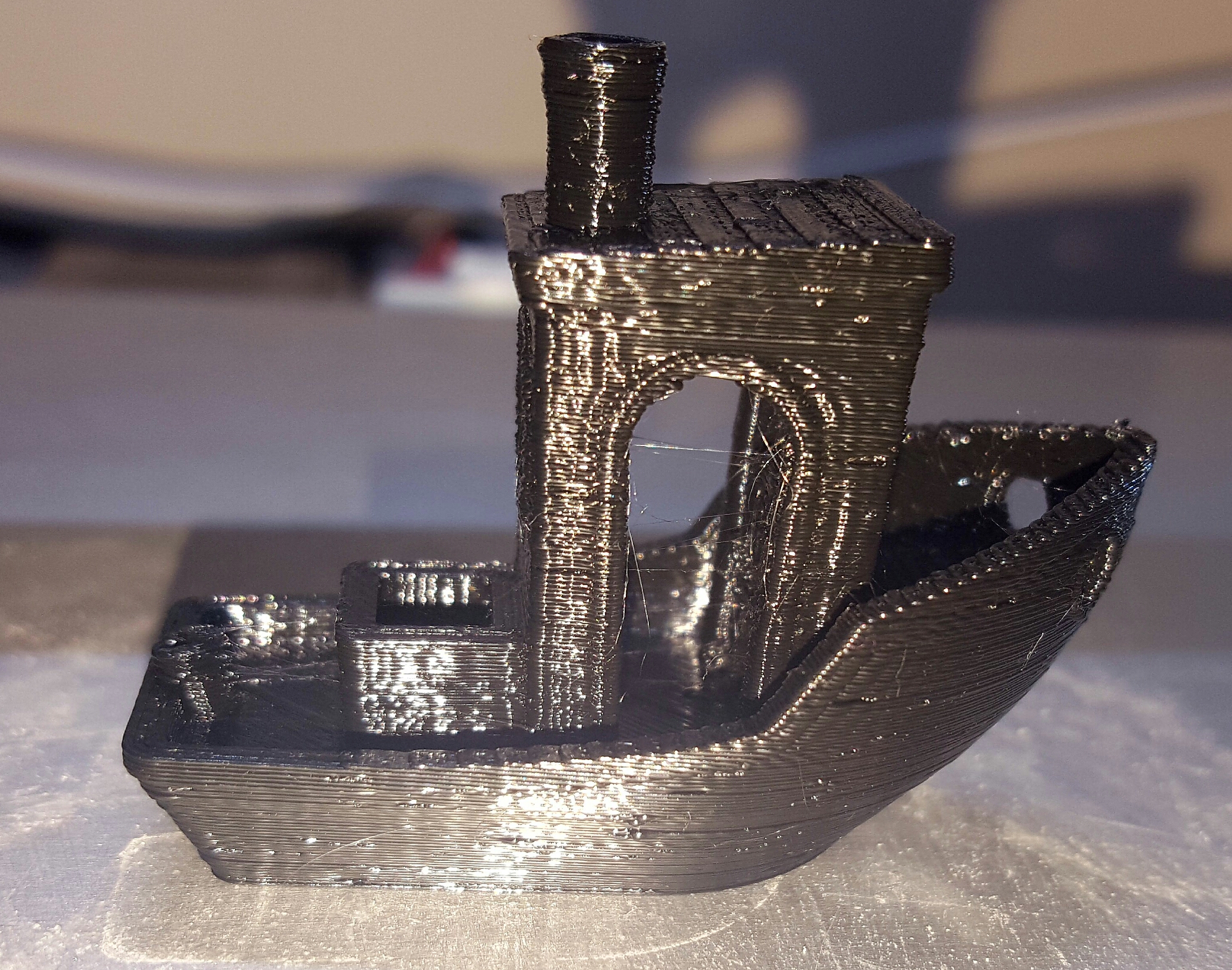

Hi how are you doing guys i have a little problem with my 3d printer anet a8 prusa i3 the first prints was good and now this is i printed this benchy.
cura 2.3.1
layer H: 0.2
wall thickness:1.6
75% scal
pla hatchbox @200c
cura 2.3.1
layer H: 0.2
wall thickness:1.6
75% scal
pla hatchbox @200c
Looks to me like a heat issue. Make sure you have cooling activated in cura and the fan is actually turning on. I also notice a small amount of stringing so your hot end may be too hot also. If the cooling doesn’t work try reducing extruder temp by 5deg.
I will try this thanx man
THIS DON @ 190C ROOM TEMB BED
layer H: 0.2
wall thickness:1.6
75% scal
+0.5MM RETRACTION
