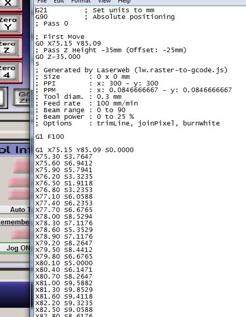

Hi, I am new to laserweb and trying to laser engrave a grey scale image in Mach3. I have imported the grey scale image to laserweb. after creating the process [raster engrave] the code is showing x axis moves only, the y axis moves are just not present.
attached is the pic of the file I am trying to engrave…when I look at the file in laser web, I see the at the red lines of the toolpath, and I see the x and y axis moves but they are not in my code when I view them in Mach3! does anybody know how to solve this, please? any assistance very much appreciated, regards Marc

yes i have tried to execute the code. what i get is very slow movements along the x axis.I did not see any y axis movements but i do see them now [sorry, didnt see them the first time] like a stop start running of the code…i was expecting the code to run smoothly from one grey scale value to the next…is my feed perhaps too slow? and what could be causing the laser to “break up” the x axis movements please?

@Marc_Erasmus I’m also noting that your speed is way off. You are doing 100mm/min that’s not correct. In setting you can change to mm/s if you are more conformtable or just input 6000mm/min to get 100mm/s
That’s should fix your speed issue

I have done as you suggest Ariel, but i only see a y axis move at the start and at the end of the code. is this a “canned cycle” where by it records the y axis movement and applies it after each x axis line? and i see mach is still trying to cut each individual value of grey-scale as an individual piece of code…? i am sure there must be a setting i have wrong in laserweb…

Y movements are there and your speed was ultra slow, not sure what else.
