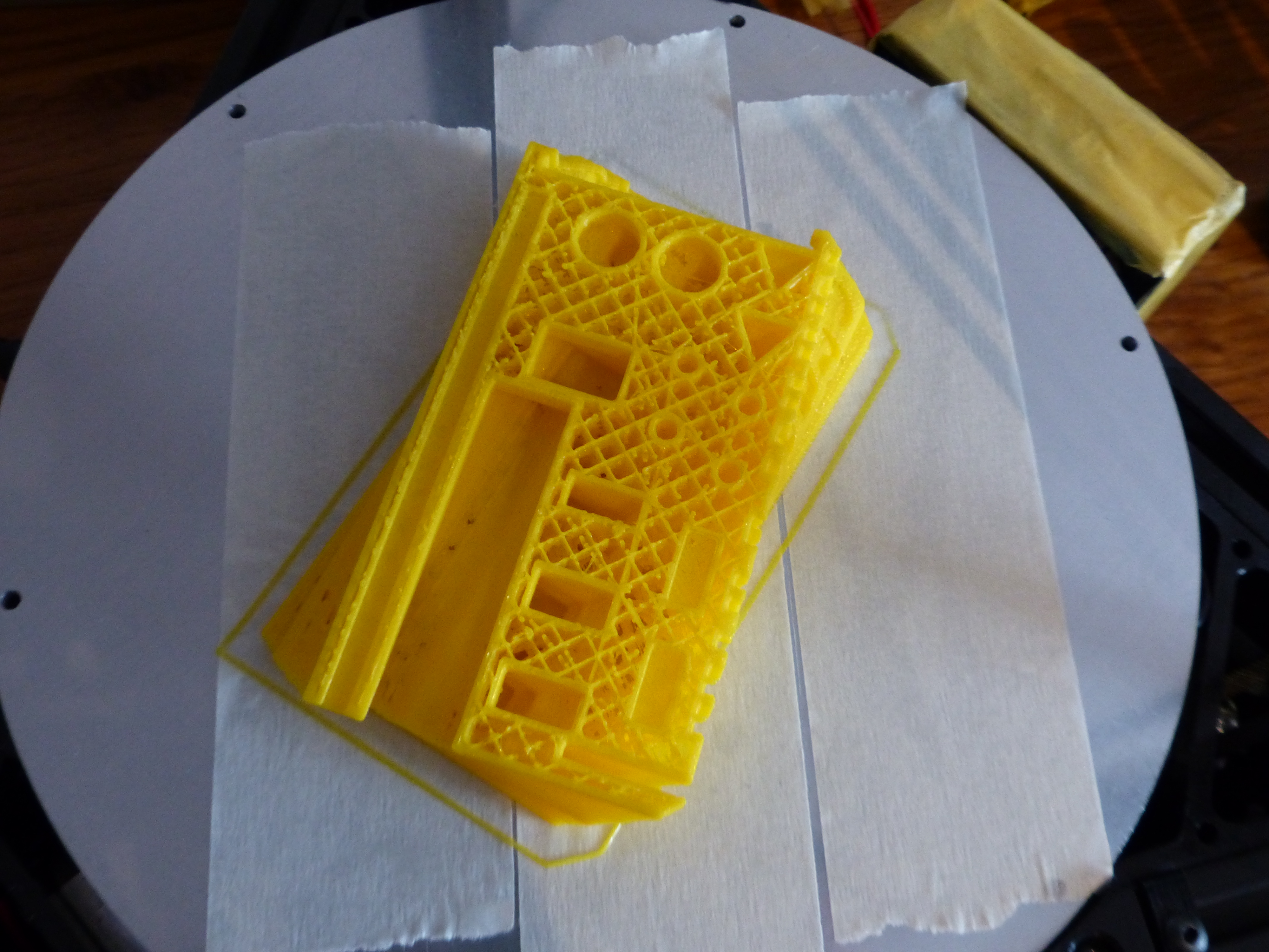

I am trying to print this rather big model which I designed myself for quite some time now, but it has yet always failed to print. First, I had problems with my X-tower-carriage slipping during the print, which resulted in misaligned layers in one direction (Take a look at the picture with the green box).

I thought I had fixed my problems, so I once again started this big print and now look at what happened!
The layers are rotated, but not in sudden jumps, but rather in a smooth path!
I really have no idea what to do now, there is nothing I could do better as it seems:

Could it be the driver chips overheating? There wouldn’t be much I could do about that. Or is the PLA lifting up? Change the temperature?
This is getting quite frustrating and although I have been thinking about this and trying out different solutions, there seems to be no way to fix this problem. I hope someone can tell me what I am doing wrong :stuck_out_tongue:
Check the motor pulley that the grub screw is tighten enough, maybe a drop of thread-locker should help.

Yes all towers of course. It seems that I was able to fix this, but I have not tried printing anything big yet. I think the stepper drivers were overheating and shutting down as I do not have any insulation material between the heated bed and the RAMPS-board (Which is right underneath the bed). I am planning to raise the bed by 20mm with aluminium extrusions and am going to add some insulation, but for now, it seems to be working with a bigger computer fan strapped to one side of the printer which blows air over all the steppers and electronics. I had a fan running at 5V (less noisy and faster heat up) but now it is running at the full 12V. I have put a filter in front of the blades to hold off any dust that would otherwise be blown into the printer.
