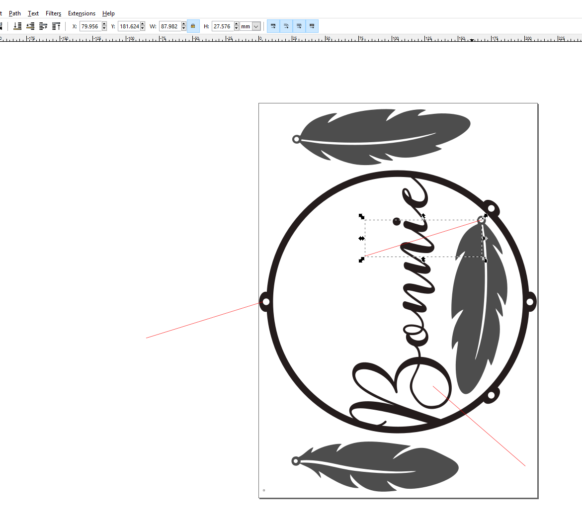

I am trying to cut out and object and would like it to cut all the inside holes first. Is this available or is there a work around?

I cannot see why my suggestion would not work under that scenario, cut outs are still shapes. Mind that you may need to remove any clipping mask on the object to see how it is composed. Is all the white area to be cut out?
Yes white parts are to be cut out. I cannot select the white parts.

Im new to inkscape so it might be something I am doing wrong. I normally use Corel.

@CescoAiel That what I thought. But it selects the entire object
Even when you open it up with the little plusses in THE CAM (now called FILES) tree?..
@CescoAiel I go to the lowest level. Still selects object… I attached my file above if you want to look

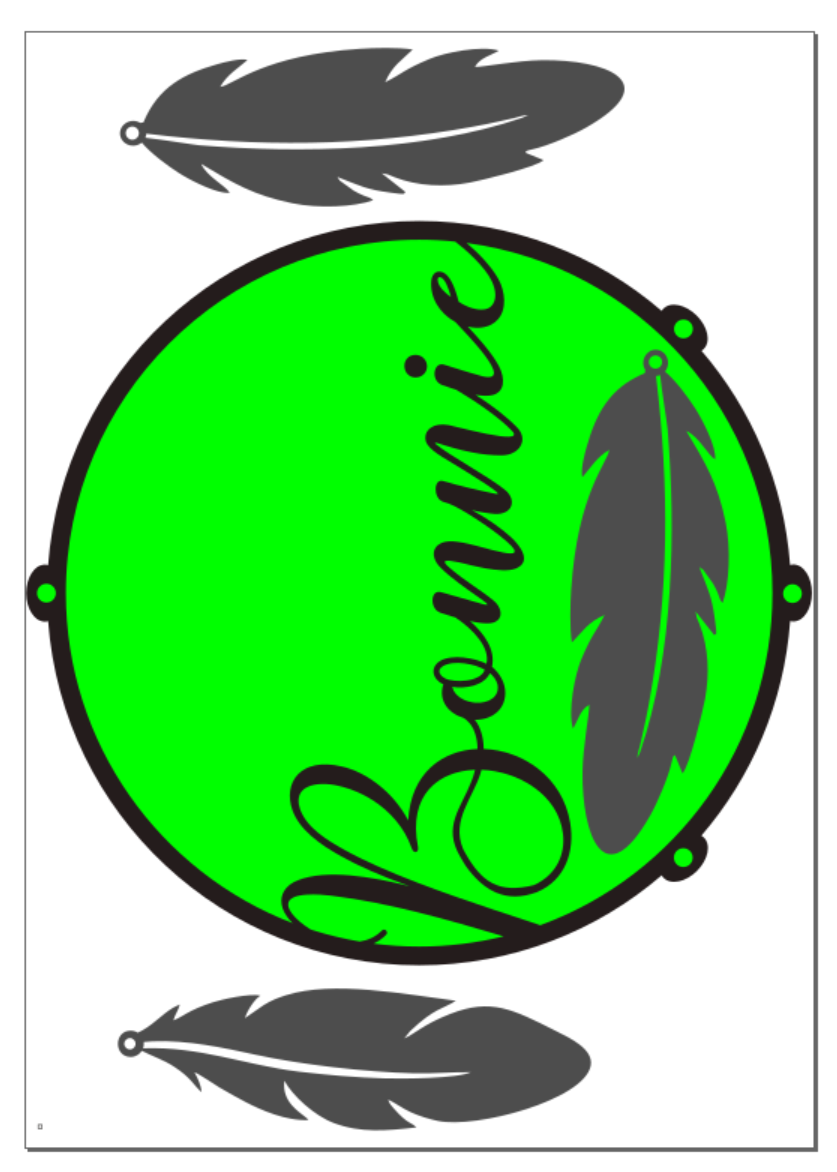

It seems the issue is that the paths have been combined as a composite path. They actually aren’t separate paths. So what you will need to do in Inkscape is use a Break Apart command (Ctrl + Shift + K in Windows by the looks of it). What this will do is break that main centre shape (with Bonnie written onto it) into 12 shapes (the main outline & 11 interior cutouts). I’ve just done it & coloured all the internals green (for reference). After doing that, I selected all the green parts & grouped them together (for ease of selecting them all in LW when imported) & left the external area (black in colour) as it’s own object without being grouped. Then there is a feather under it all that needed it’s layer moved to the top (using either Object > Lower to Bottom or Object > Raise to Top, depending what you have selected). Same with the dot from the letter i. See attached screenshot.
Also, link of edited file: https://drive.google.com/file/d/0Bzi2h1k_udXwTVFoeDYyRnA5aVE/view?usp=sharing
