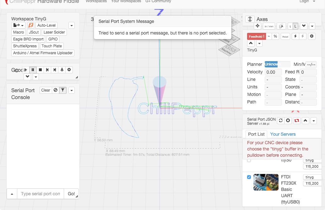

Hi, i am trying to get my Mac / chillipeppr / rpi3 / tinyg - setup running but without success so far. serial-port-json-server-1.88_linux_arm is up and running and i can connect to it with chillippr but i always get a serial port system message saying that there is no port selected. I added a screenshot to better show what i am talking about. Any help is greatly appreciated. Cheers.

Just uncheck the TinyG and re-check it. It needs to be green to show it is the “default” port because CP can connect to secondary ports for controlling other things like lasers.
