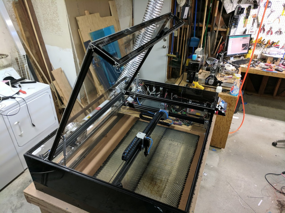

Here’s a picture in case anyone is curious. I took it to the San Diego Maker Faire at the beginning of October where it was adorned with a pretty blue ribbon. I just want to be able to unlock the full potential of this beast and finally get rastering to work. :-/
nice build! are you planning on sharing the build info with all of us curious fellows?
have you tried the fast stream script provided with smoothie to stream a gcode file, see if that helps ?
I second the request to share the build info. Santa wants to give me a K40 but I could convince him to buy the laser tube instead

@Domm434 @Samer_Najia I tossed together a quick Wordpress page about it for Maker Fair goers to visit if they wanted to see more pictures, read my FAQ, and see the detailed parts list with all pricing and links included. You can find it here. https://lasermandan.wordpress.com
I didn’t want to go the ever popular K40 route because they are really small and everyone who upgrades their tubes end up with a K40 with a massive tube tumor hanging off the side.
