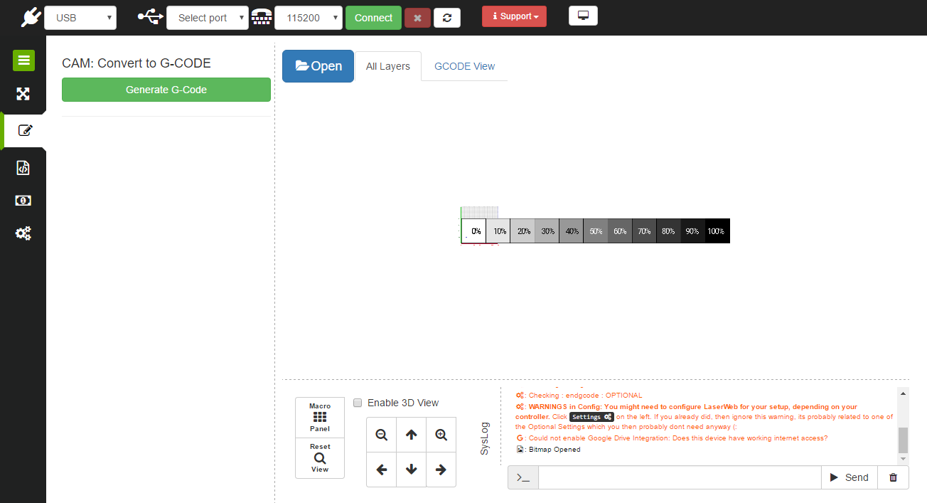

I created a file in Inkscape(linux) and converted it to bmp & png.
When I load the BMP file on the Win10 Laptop in Chrome (local WIN server) it loads the file & displays it but underneath "Generate G-code nothing appears.
When I add a second file then the first one also appears.
When I load the the PNG first, and then the bmp , again the PNG loads fine and the controlls appear but again the BMP loads but no 2nd tab appears under “Generate…”

I used GIMP (Linux) to export as BMP and under advanced options I selected 24bit colors
In Linux NO problem with the same files
( bmp first and then png )
Windows shows the first BMP but NO tabs only when I add the second file
