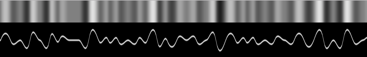

I experimented with the 1D 8 bit noise function and created this variant that directly generates noise in the range -128…127. No need to scale it, i.e. no _raw variant. The number of multiplications is the same for the not _raw variant, but the result looks very smooth. What do you think?
