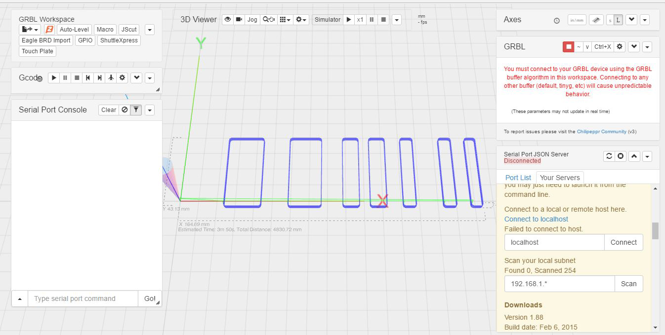

Can you post a screenshot
Hi John, here is a screen shot of chilipeppr with some Gcode dropped in, I have tried everything I can think of to connect and don’t really know what to try next, but I am new to Chilipeppr.
What computer is your Serial Port JSON Server running on? What is the IP address of that computer? Or better said, are you running SPJS on localhost? If so just connect to localhost to get connected to SPJS.

OK John I think I have this worked out, maybe I did not understand it in the first place. I had installed JSON and closed down the black terminal window after installing it, thinking this should only need doing once, I find with a little experimenting that if I install every time and leave the black window open it connects perfectly every time, I only need to select grbl instead of default by the com port and check the box and it all works.
I have tried this on 2 windows 10 machines and it is the same on both, is this how it is supposed to be done ?
