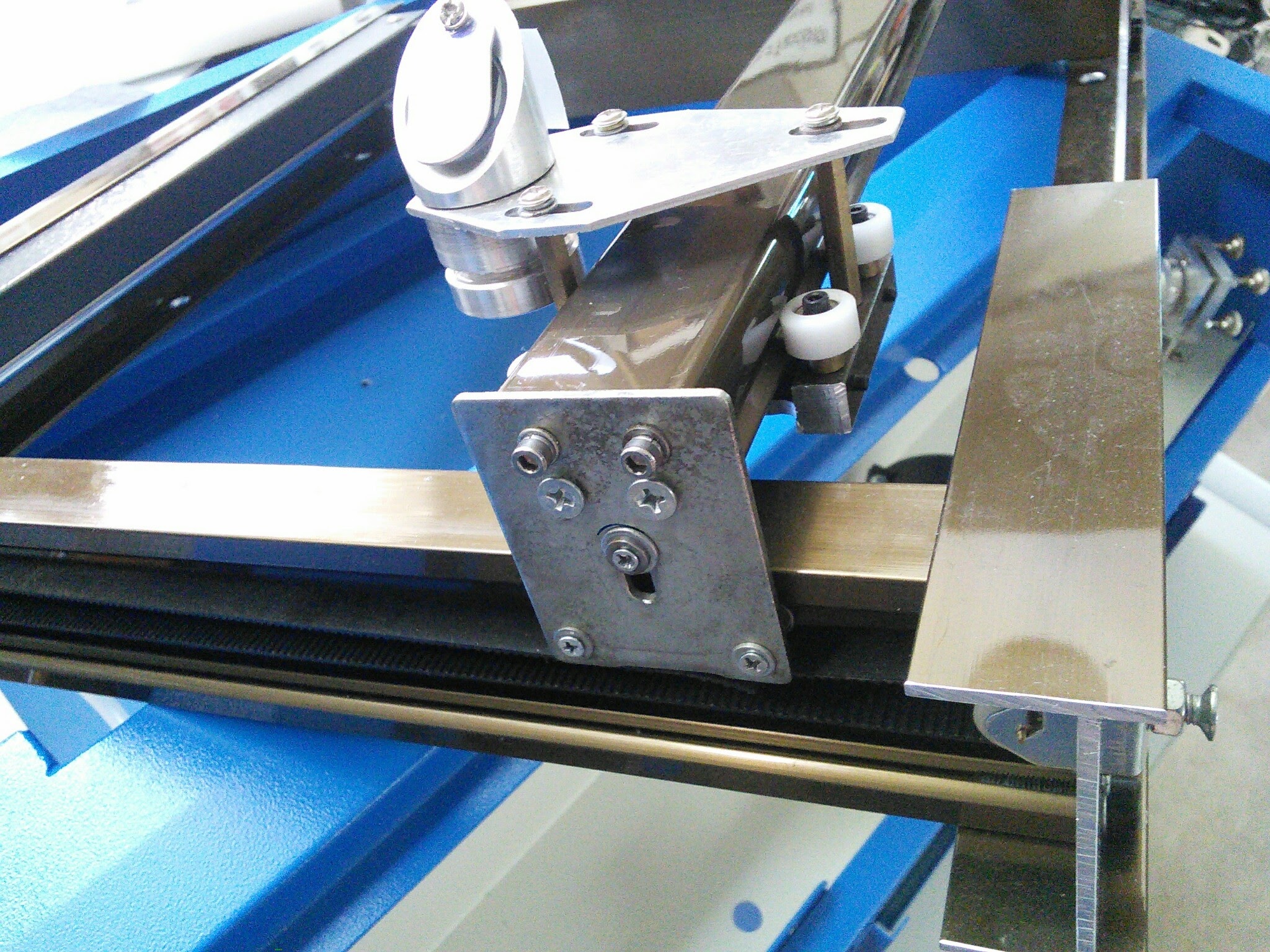

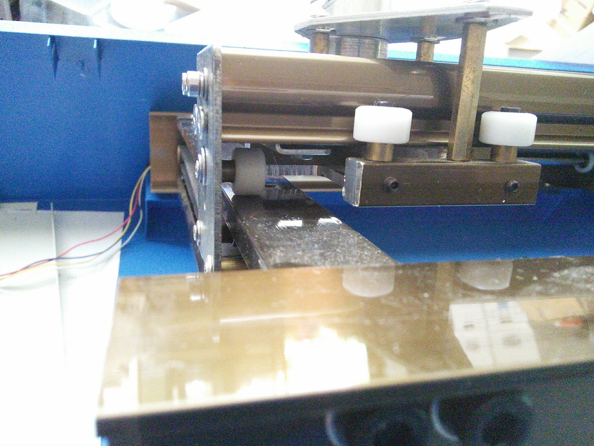

(5) [Only If Necessary!] If the numbers are off, you need to adjust for a parallel plane before you start fiddling with the mirrors. The height of the gantry is determined on the left by the silver rod that the gantry slides on front-to-rear, i.e. the Y-axis. However, the right side of the gantry height is determined by an idler roller which can be adjusted if it happens that the right side of the gantry is slightly high, or low. This is a common problem as this adjustment can get knocked out of alignment.
(6) The idler adjustment, if needed, is at the far right of the x-axis. See photo. On some machines the adjustment can be accessed thru the “porthole” on the divider panel that separates the laser work compartment from the electronics compartment. (Ignore most the screws: The top two screws attach the end plate to the end of the gantry extrusion. The next two screws adjust the tension of the x-axis belt. The bottom two screws attach the plate to the y-axis drive belt. Don’t touch any of them.)
(7) In the center is a screw with some washers and a vertical slot. Inside it is attached to an idler roller. Moving the screw high of low in the slot will adjust the hight of the right hand of the gantry to match the height of the left hand (previous mentioned as fixed by the silver slide rod).
(8) Once you’ve made the adjustment, go back and measure the heights again at each of the four corners. (described in step 3, above).
(9) If it turns out that the height numbers are off in the front-to-rear direction, this means that the silver guide rod is off. That’s an entirely different problem, and rarely an issue.
