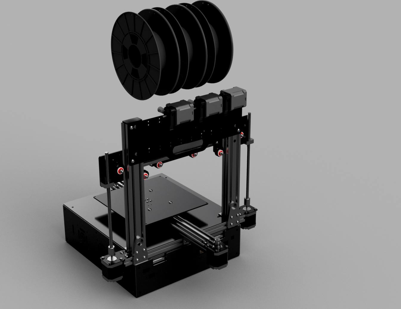

I have started a project where I plan to test the Diamond 3in1 nozzle for 3 color or color mixing printing.
I`m going to use my OrdBot test printer in this project. To make it possible to install 3x extruders + PSU + Electronics… I have designed a “OrdBox” where I can install the LCD controll panel, PSU and electronics.
I plan to install hinges in the rear, so it is possible to open the “OrdBox to access the electronics”
Hope to get a clean setup using this.
Next I have to design extruder and filament reel mounts.
For the Diamond 3in1 setup i Plan to use:
1 x Diamond 3in1 0.4mm nozzle
http://reprap.org/wiki/Diamond_Hotend
3 x Hexagon heatsinks/heat brake
3 x Pushfit/tupe kits for Bowden
3 x MK9 extruders
The OrdBox is made using 20x20mm alu profiles and 2mm side panels
