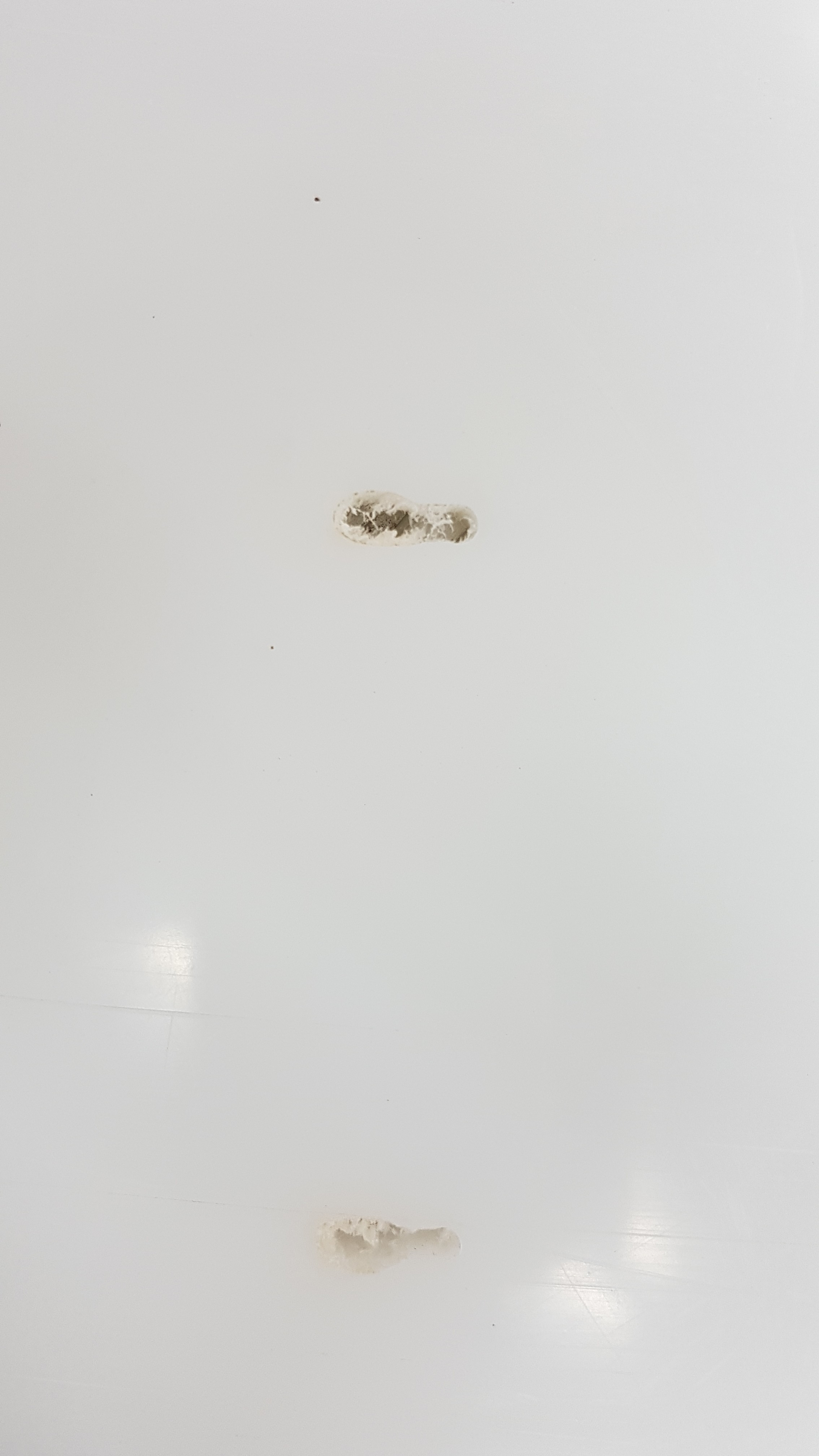

- I finally got the unit cutting and moving properly after finding Fusion 360’s CAMing software which is fantastic but trying to cut a 5mm/10mm keyhole in MDF and HDPE for mounting with a 3mm flat end mill ( tried 2 different type bits) it just cut horrible so inaccurate cuts. I slowed it down to 400mm/pm and even did 1.5mm passes but still was so bad. There’s no flex in the 3D printed mount so if it’s that it must just be the stock OX…
- Possibly related to above, I cut out a rectangle in the 16mm MDF and 12mm HDPE which was supposed to be 294x 224mm which ended up being 287x220mm so I changed the revoultions from 60 to 58 and got 303x 233mm so I thought I would try doing a quick check and calibrate it by doing a quick drill operation, send it 100mm x drill then 100m y and drill… and it was spot on the money to the 0.10mm.
Checked the Gcode and it was no different to the last cut which was so off… Just soooo frustrated!!!

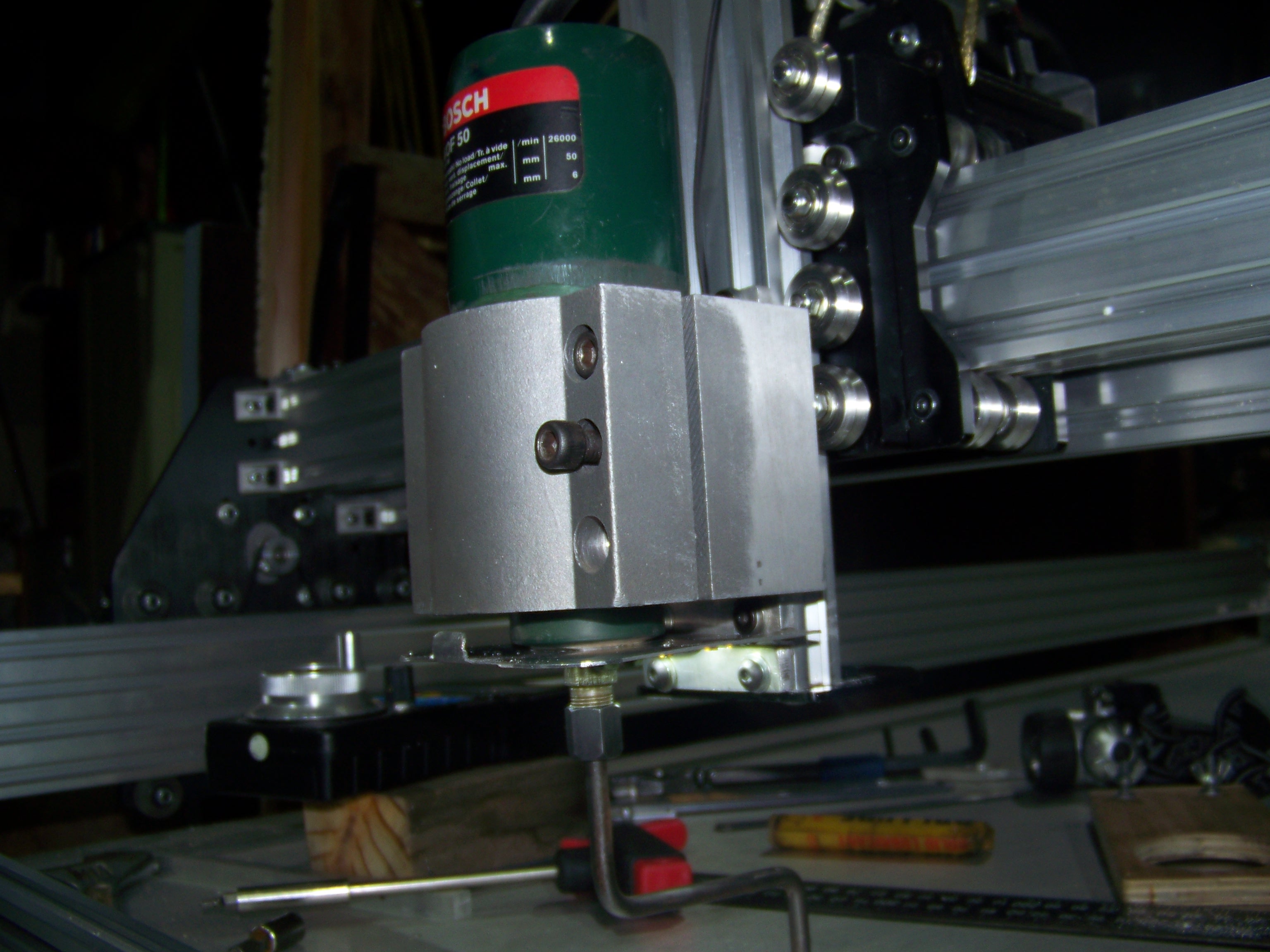

Mitch I have a Large Ox also and have had similar commissioning problems. I am a complete noob at cnc also but I did notice one thing that may be your problem that I have overcome, your spindle mount.
I had a Dremel tool as a spindle at first but have recently put a small Bosch router on a nice solid mount and just tonight I have finished replacing the Exreme wheels with stainless steel ones (bought 30 through aliexpress for $80Au)

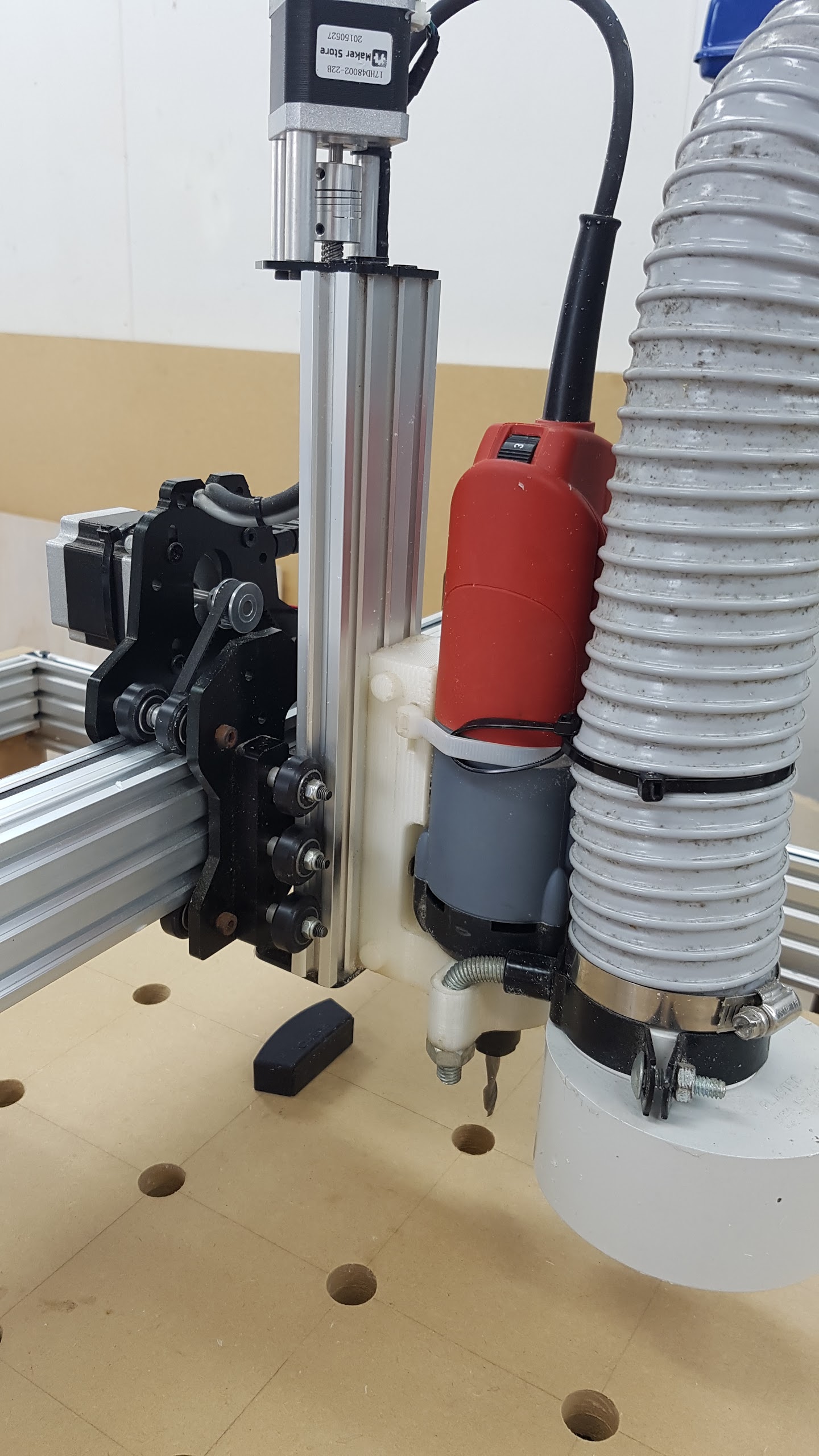

@Mick_Hatton the spindle mount on my Z has zero play thankfully. It was 3D printed from another user and is cable tied and bolt tightened on. I’ve played with it and found the only give is in the Z axis but really isn’t that bad for the results in getting…
@Mick_Hatton comparably to the Z axis give in the rollers they had way less. The 3D printed mount is made to fit around the spindle and cable tie mount is just to secure the top. The bottom is clamped with 2 bolts. I’ve tried wiggling it and it’s not the issue
I had a major improvement in accuracy after installing the 4th pair of wheels and proper spindle mount, also do you have your X axis 60mm extrusions glued/joined together ? I used 4 pairs of these to join mine for extra torsoinal rigidity.

The spindle doesn’t move in it’s mount. The whole neck of the Kress is in contact with the mount and has two bolts compressing it in. The 3D printed mount is solid and was designed to perfectly wrap and hold the top of the spindle. Cable tie isn’t lose at any contact point. When you try and move the spindle on the z axis the movement is in the wheels and mounts that connect it to the gentry. I could mod it and add dif wheels and extra wheels and more belts or even change it to direct drive threaded rod on all axis but as my thread originally pointed out… I’m pretty done with the whole thing. Keyholes shouldn’t be a problem to cut out with a completely standard Ox build but it’s not on my machine. I’ve seen peoples builds that are considerably less rigid than mine produce much accurate cuts. The main reason I posted was to find someone to visit and advise in person as there are too many variables to go over here…
