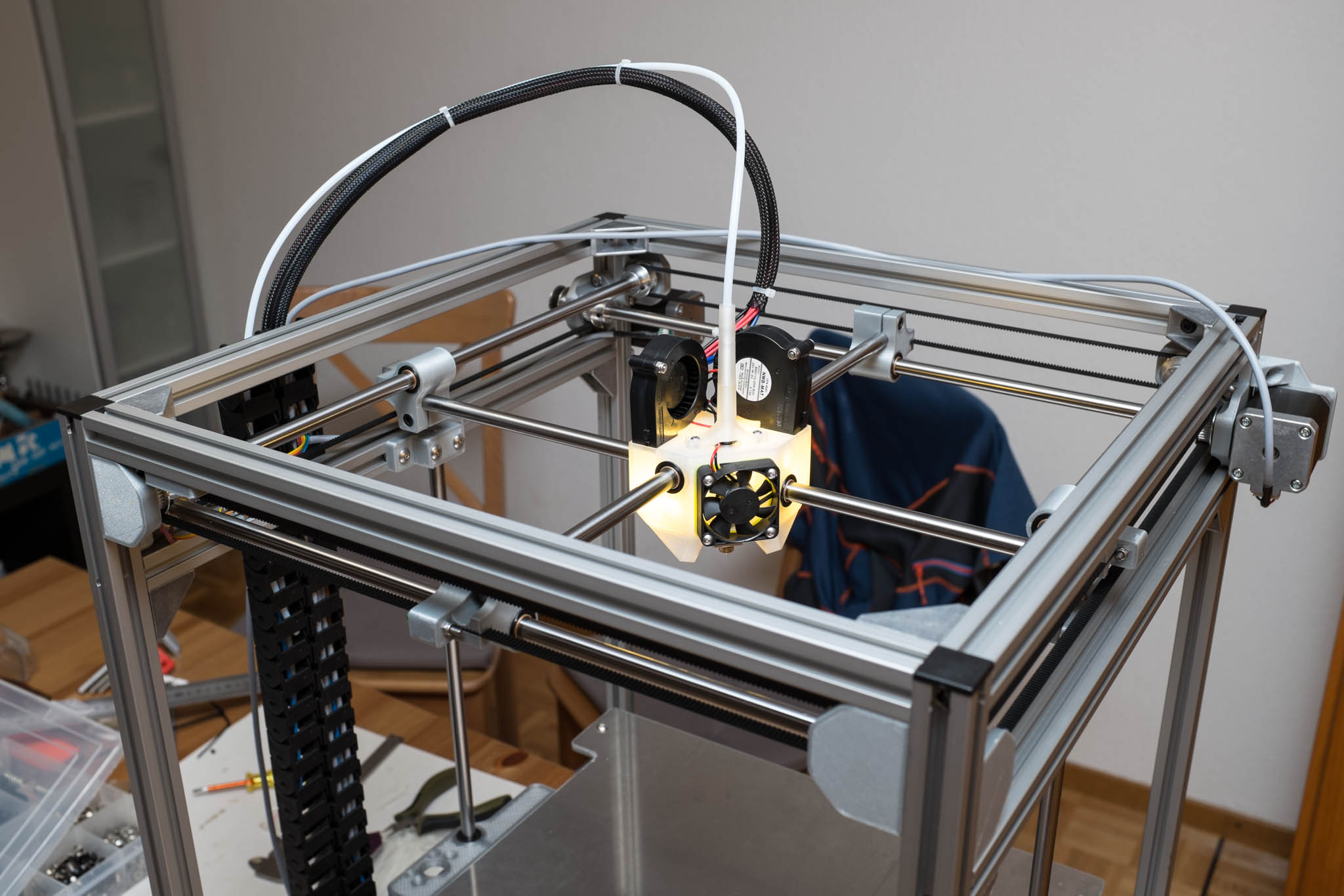

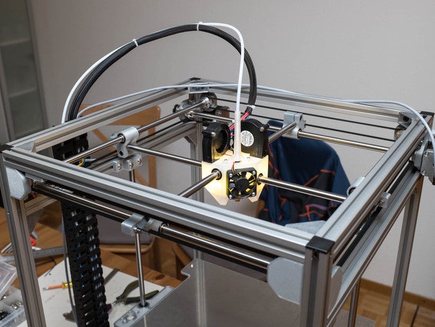

The carriage is up and moving. Wiring is almost done.
I used the alignement tools with the printer upside down, they worked great. The carriage has a little resistance I don’t know is it due to alignement, belt tension or when I tightened the M5 screws on the belt tensioner. I’ll do some fine tuning later.
That carriage looks awesome. Nice wiring job, too!
Run the carriage into the corners by hand and check for increased resistance. If you get increased binding into corners you will want to tune the lower side rod positions to eliminate the resistance.
Also run the break-in gcode, then realign. The bushings have a little time to settle in. But once they do you will be very pleased. Once everything is right, you will know it.
Looking great. Can’t wait to see your first prints.
@Eclsnowman Thanks. The corners looks fine.
How did you generate the break-in code ? Because my print area is smaller with this carriage. Btw I can use find & replace in the gcode.

Break-in seems fine, it still need some angles tuning to have perfect squares.
PID auto-tuning is done. Still waiting on the correct Z ballscrews and 3m tape for the heatpad.
