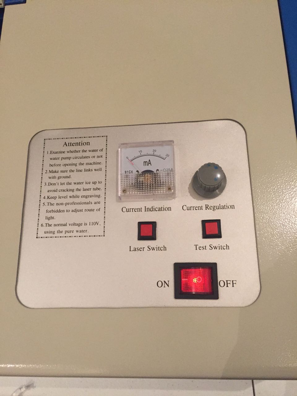

can you post a picture of your top panel?
@dougl Everything turns on fine, I don’t have an E-stop, but the button turns on I think it might be another problem, do you now what else it might be?

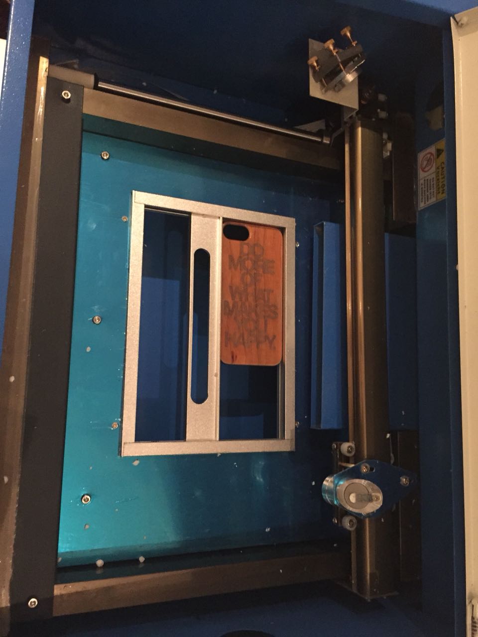

This is the laser head when I turn it on @dougl
